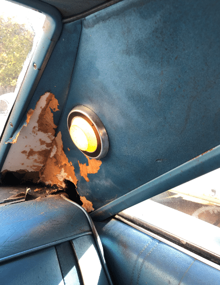

So I have a 68 Fury III and the interior is great aside from the sail panels and headliner.
Now that I got all the electrical working like it should, I was hoping to buy some new blue sail panels but I cant find a 100% guaranteed fit for this car or the original color blue as an option. When I was looking for courtesy light lenses I had to image search for the one my Fury takes and no where does it say it fits this car.
So what gives?? What is it about this car that I'm missing when trying to find basic parts?
Does anyone make sail panels as a correct color/fit for it or am I making my own?

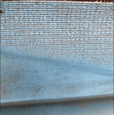

Also, does anyone make the correct material for the headliner? (second pic is what's in the car)

The lights are basically everywhere. Most people aren’t going to list them as fitting your car as it’s not necessarily the most popular model to sell them for but:
https://www.ebay.com/itm/Courtesy-L...088596?hash=item35f6df2fd4:g:AR8AAOSw3pZbBg-4
Those are them (as an example)
The sail panels are another issue. Your gonna need to go with used parts and likely dye them to match OR for that and the headliner: SMS Auto Fabrics - The Largest Selection of Classic Auto Interiors
find your interior code and send it to them for samples. They’ll get you close if not on for the headliner. They take forever and cost a lot but they also do door cards so I can’t imagine they wouldn’t do the sail panels was well.

SMS has that pattern for headliner. They may send you some other samples first. If they are wrong, send a snip of a hidden corner from your original, they have it.
I had to paint black sail panel to red for my car. I had the guys that were doing my paint do a color match on my old brittle panels and they sprayed them. Turned out perfect. Don't ask me how much it cost as it was in with a bunch of other parts and a very small cost in the scheme of things.

In the world of trim shop supplies, the sail panel items are probably built from the same "board" as the backing for the door trim panels. "Cut and contoured to fit", then covered with color or vinyl or whatever to make it look right.
As for the sail panel courtesy light lens, it would not surprise me if some for a popular GM car might have the same diameter and housing, but with a different lens crown shape. Might even be the same as other Chrysler products, too, as mentioned.

I would just get some extra material when ordering headliner and recover the sail panels. You should be able to repair them from what I see in the picture. This way at least they match the headliner. My Monaco sail panels and sun visors use the same material as the headliner. May not be Concours correct for your 68 but I doubt anybody will notice.

Thanks for all the tips. SMS seems to have a TON of really cool material just in general. I'll contact them after work today for samples and pull the sail panels out this weekend and see exactly what I have to work with.
The sun visors are perfect. Headliner is mostly missing and the sail panels are toast due to rats at some point in this car's life. A lot of chewed wiring which I actually really enjoy fixing wiring, so that gave me something to do and learn about. All fixed now. Everything works. Got a map light yet to install in the upper dash panel.
I was hoping to buy "off the shelf" sail panels but I have no problem making some or painting some. This is all really good info! Exactly the stuff I was hoping for.
