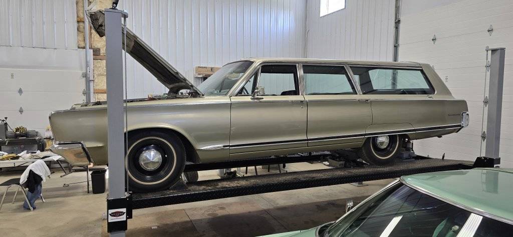

OK I am getting flustered on tires/rim/hubcap. I have the original 14 inch rims but having a hard time finding the tires for it, small whitewalls and a 225/14 tires to fit. So I wonder if I got the 15 inch rims what my factory hubcap I could get. Is the "Disk Brake hubcap" the only choice? Could you get 15" rims as a option without the disk brakes? Or can I find 14" tires that will work other than 14 ply trailer tires? Do not want repo tires from Coke. They are fine for display but I want to drive this wagon as much/far as I can. Thank and now back to the brakes on the wagon (11X3). PS the NOS seal I got from Mr McGowan worked fine and now the transmission shifts fine into reverse.

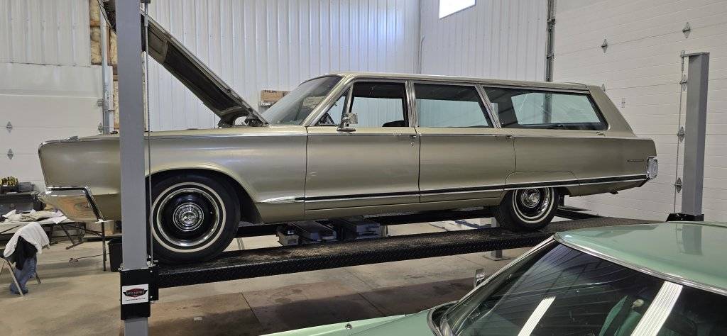

Here's what I've had on my 66. Generic Mopar poverty caps and the rare original poverties with Chinese beauty rings. 15" wheels mix of original and wheel vintiques
Those Chrysler hub caps are correct for that model year and a few earlier, possibly back to about the earlier 1960s. The smooth caps started in about 1969, as I recall, to compliment the smoother Fuselage styling?
