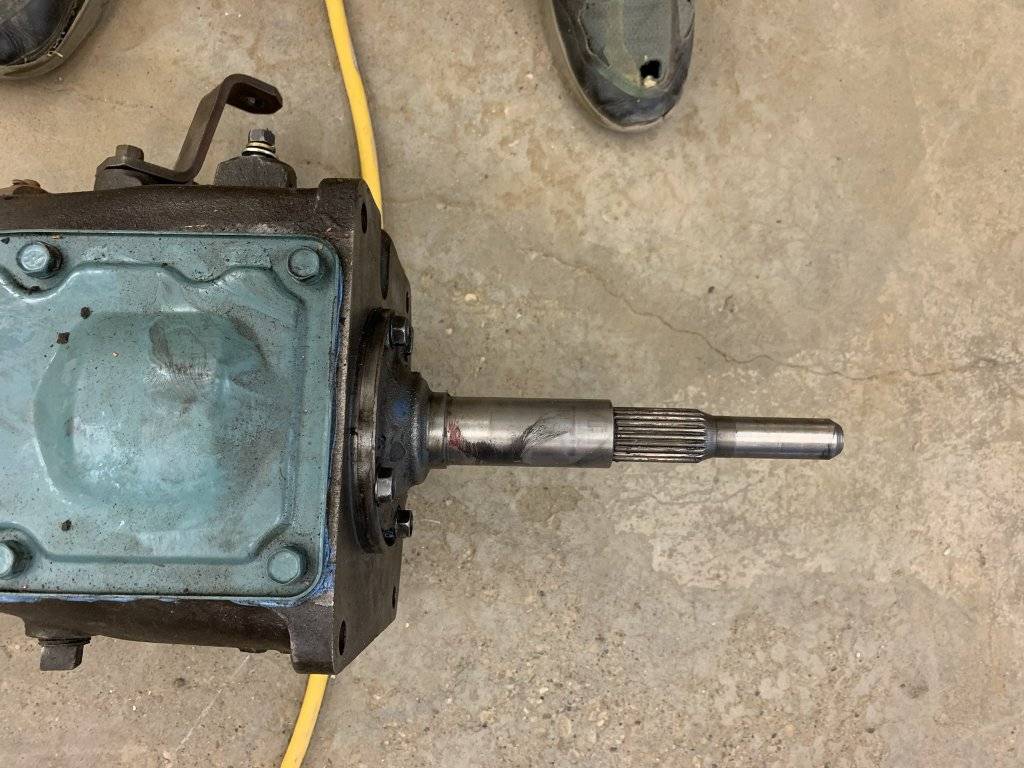

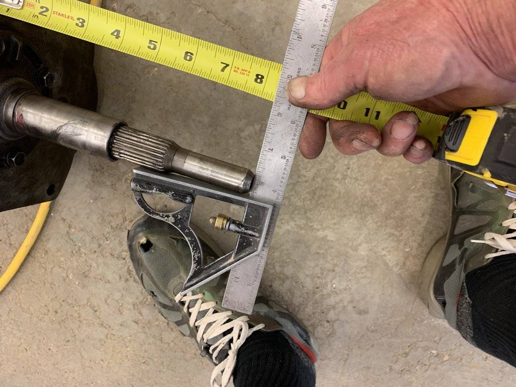

If you happen to have a 833 or 745 transmission laying around, could you take a measurement for me? I trying to troubleshoot a problem and I am wondering if the input shaft is too long.
I need the dimension from the transmission case face to the end of the input shaft. Try to be as accurate as you can.

Now I pulled the transmission and also the clutch. Clutch all looks fine. The pilot bushing has needle rollers so very low friction. It appears in good shape. I am wondering if the end of the input shaft is bottoming out on the crank. The input shaft appears to have been rubbing on something but there is no evidence of that in the crank.
I drove this car all last summer and for a month now this year. But the spacers between the trans and the bell housing were still in there.
