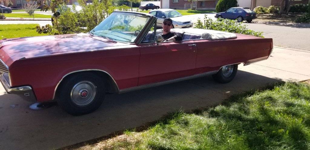

Post up some pics.
Here are a couple pics. I'm putting 22" rims on it this week despite public opinion.

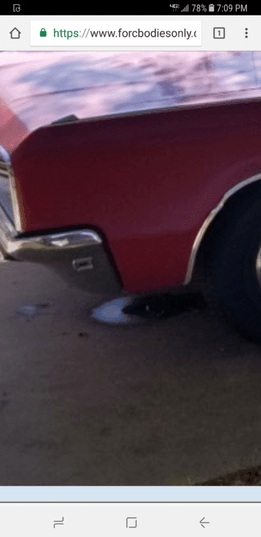

Previous owner didn't tighten the transmission pan all the way after doing some work. I've got that taken car of but putting a new gasket on next week regardless.
I think mr gasket makes a steel core gasket for the 727 i have one on my wagon.
I have the gasket. Gonna buy a new filter and fluid this week and took a day off next week after the cold is gone for a couple days and will get it 100%, but that picture of mostly driveway repair related and not actual hemorrhaging leak

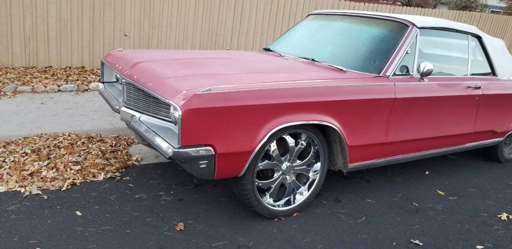

Skip the 22s and put some whitewalls on it, no I’m serious. Nice car the way she sits though.
Bought these used and don't have proper back space so waiting on a spacer but here is a pic with the fronts mounted
