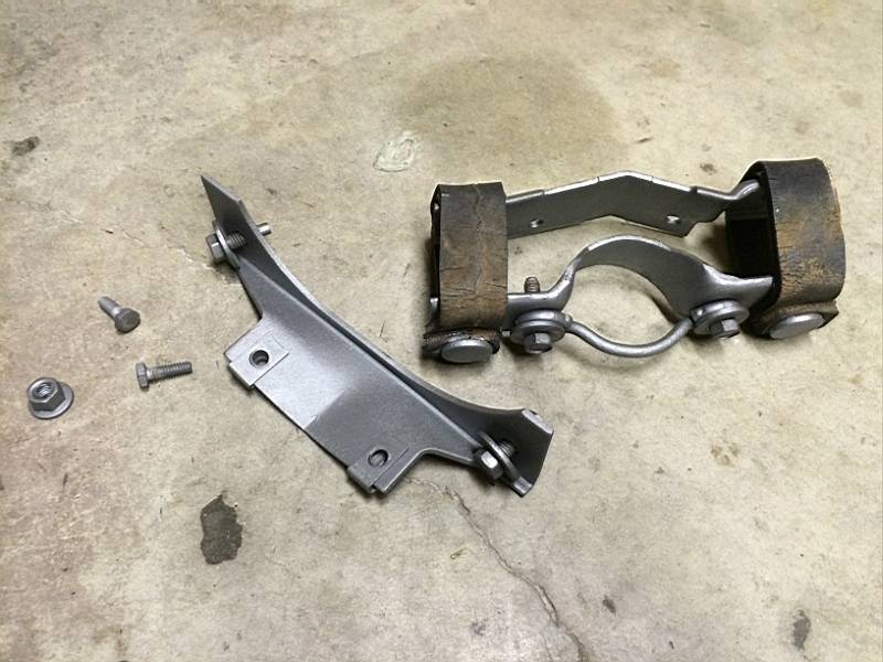

On the 69 the left side uses a secondary bracket to attach the hanger to, this is over the differential, the only other hanger is at the bumper and is the same on both sides.
Now the 73 may be different but the point is the rear probably uses the same hanger on both sides
The fronts are different plus the addition of the bracket on the left.

Great, exactly the photo I was looking for. I found a few muffler hangers like that on feebay, maybe the shop can just fab a bracket similar to what yours looks like, to properly attach it to the cross member.

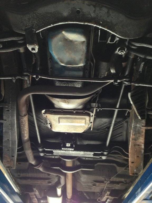

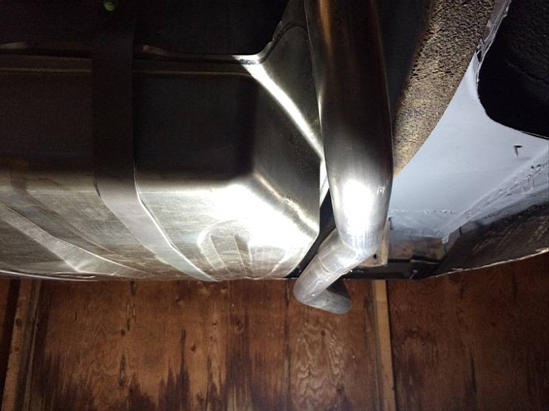

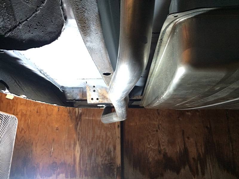

These pictures are of my 75 NYB dual exhaust. They may or may not help you. I was in a bind because my old system was rotten so I purchased 2 flow masters and had a local shop install everything, there are certainly things I’d change, but until then I’m happy.
This is the factory placement of the tail pipes on a 69,
As you can see the pipes run under the frame, the left corner of the tank is angled to make room for the pipe to get through.
Alan

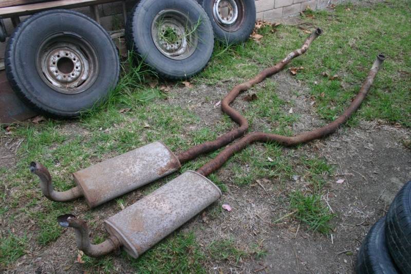

No pictures of the pipes installed, a couple of the original pipes out of the car
The second picture better reflects the placement, just increase the space for the driveshaft.
