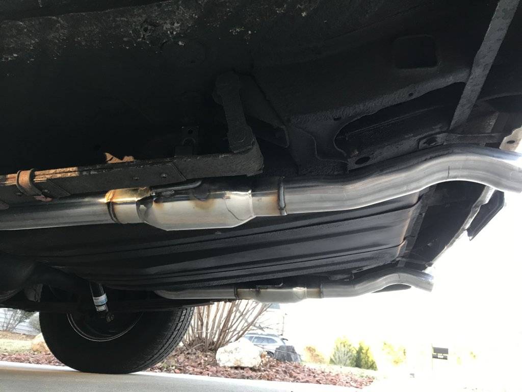

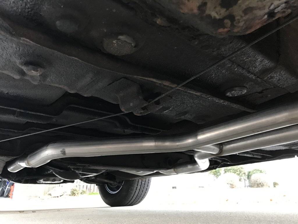

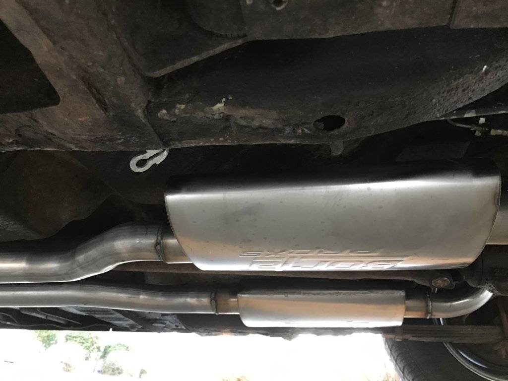

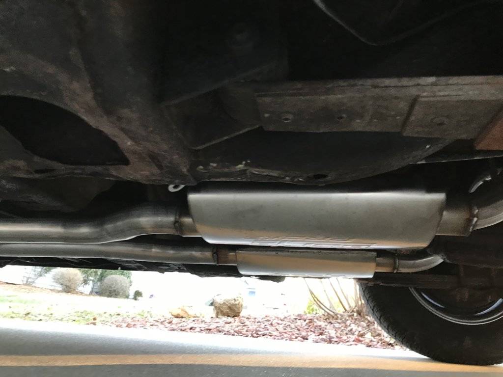

    Thought you guys might like to check out the new exhaust system on my Fury. All custom bent 2.5" pipe with an H-pipe installed. Borla mufflers and resonators. Amazing how much better the car runs with the original factory engine...it just seems to breathe better. I originally went with just the Borla's but there was a lot of drone at 1600 rpm. My buddies said it sounded good but it was annoying to me. The resonators helped remove the drone and lowered the exhaust note a bit.

    Thanks! it sounds awesome....nice deep rumble but not intrusive. It really has a wide open exhaust now as neither the Borla's nor the resonators have any baffling.

    Rear resonators to change the resonant frequencies of the system.
    Looks great under there!

    Resonators do help cut down the drone depending on the length of the resonators.
    The longer the quieter.
    I personally would have went with longer resonators.But again my personal taste not yours
    Heck even some factory 440 cars had resonators (on single exhausts anyways).
    At my shop we use Cherry bombs or Purple Horny's as resonators. Cheap and works very well with any muffler you run.

    Yeah, it's personal preference for sure. The space is a bit tight and the smaller resonators took up less real estate.
