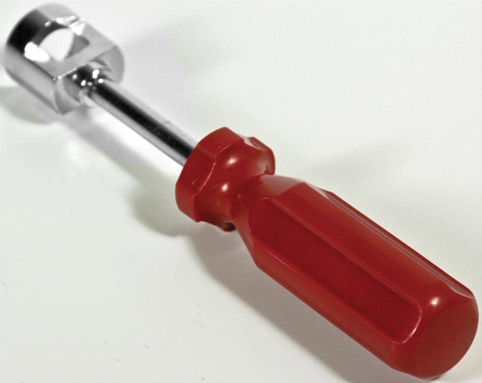

Been seeing a lot of posts like what is a timing light, dwell meter etc figure lets do a New to the car tool kit. We have them to expect a normal wrench/socket set and screwdrivers except that lets make a list of the not so common tools you want to have around
Here is my down and dirty recommended starter tools for a NOOB
Decent Tach/dwell/volt meter
Timing light
Vacuum Gauge.
Distributor wrench
Feeler gauge
Brake tools
Jack Stands
Factory service manual hardcopy or know where to find it online.

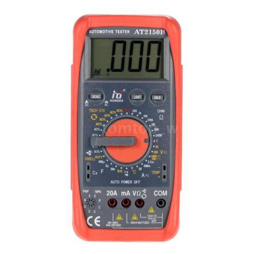

A decent meter I found for a spare in my car is this on one line for about $30. Perfect first meter it does volt/tach/dwel/amp/ohm and temp. Works really well.

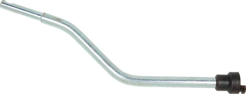

I'm interested in what comprises "brake tools" in your list. I've been learning what tools I need along the way and brake work is coming soon.
There's really only two specialty tools you need for drum brakes. One is the tool that compresses the coil springs that hold the shoes on and the other is the tool that takes the brake springs off and on.
An adjuster isn't a bad piece to have and they're cheap... You might even get one in a combo set with the above tools.

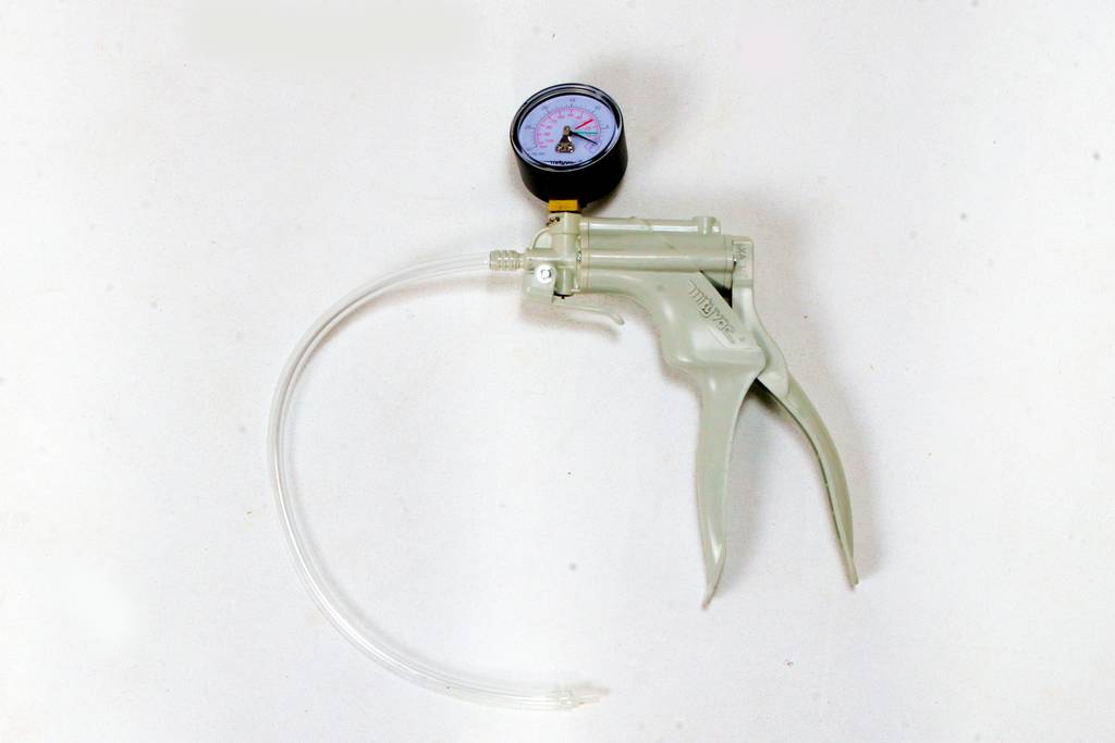

The other tool that I use is a vacuum pump for bleeding the brakes by myself. Harbor Fright carries a Mity Vac kit, which is a good one to have. You'll find other uses for it like checking operation of vacuum advance and the vacuum actuators on the heater/AC boxes.

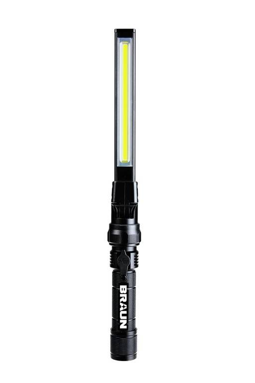

I found the greatest light at Horror Freight. Rechargeable LED with a magnetic base. Catch them on sale for about $20... buy two so one is always fully charged. Folds 90 degrees either direction, has two settings for the big light and there's a small flashlight type LED on the end of it. If my Dad had this, I never would have heard the phrase "Shine the damn light over here" when I was young.
390 Lumen Magnetic Slim Bar Folding LED Worklight
