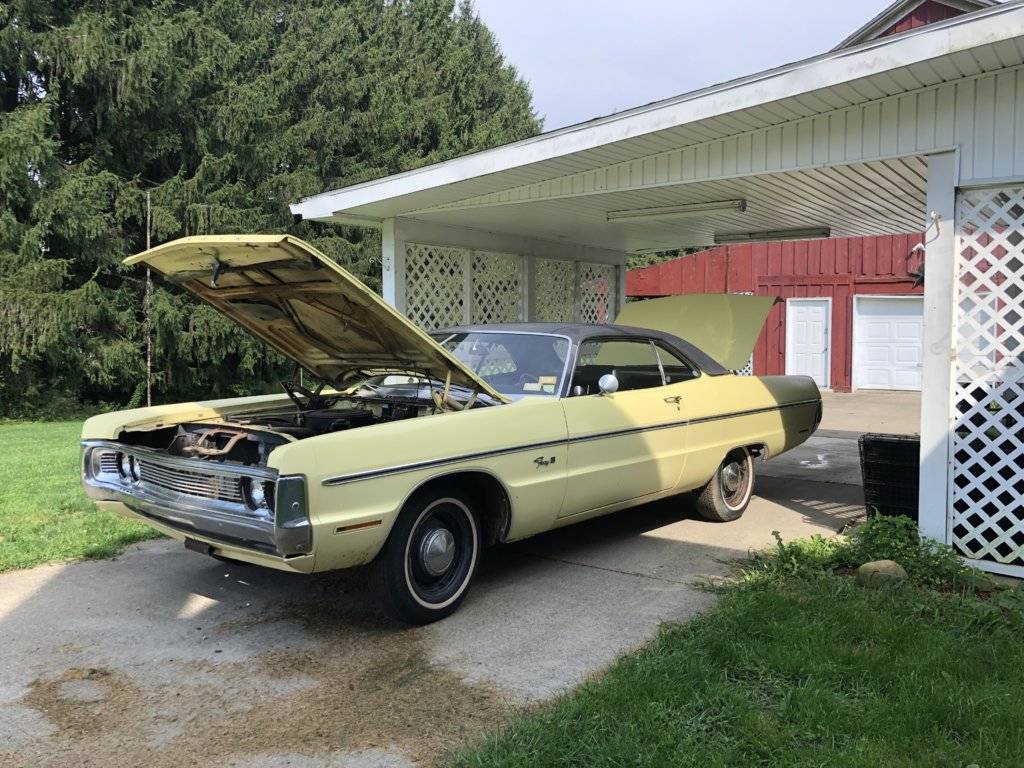

    Few weeks back I purchased a 1970 FuryIII that sat off the road since 1988 off an older fella. I got it running that day and driving the next day. Come to find out the trans was spent (3rd) and reverse. Just got the car back from having a transmission rebuild. Here’s some pictures of my Yacht. Thanks Boots

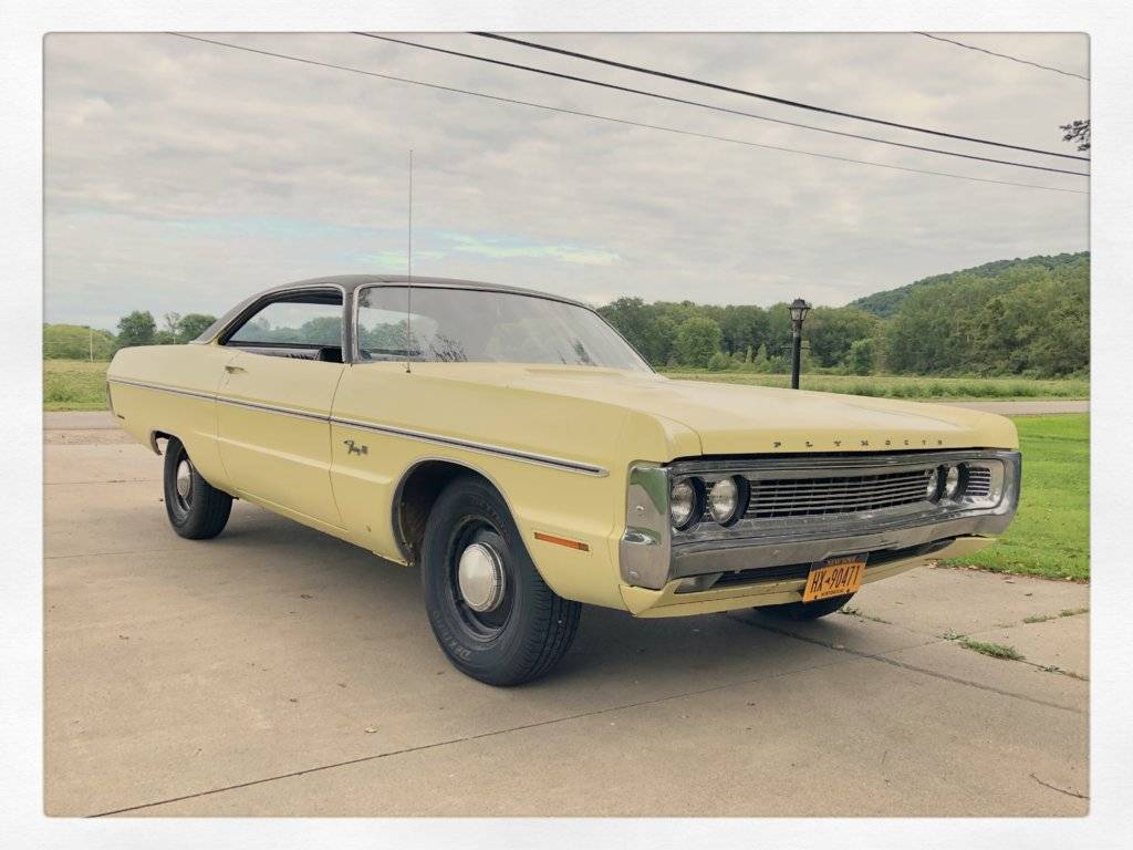

    Congrats on the new car...and this is the way to make an introduction as well. ;)
    Heck Yeah love the steelies with caps!!!

    Im a sucker for steel wheels and caps!

    If that was a NY state car it musta been in a garage or barn for all these years. Looks like it's in nice shape. Congrats to you ,the car looks real nice. That was important to me too to have my wife want to ride in it. Smooth nice ride and a car that today is much more rare than a Duster or any of the other "cookie cutter cult car" rides. thanks for posting and welcome!!
    :thumbsup::welcome::usflag:
    PS Steelies with dog dish /poverty caps rule!!

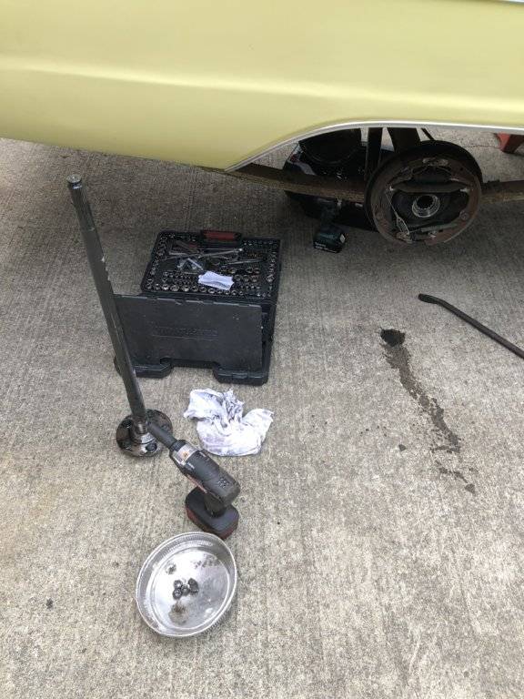

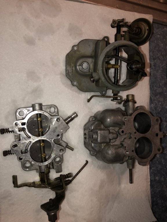

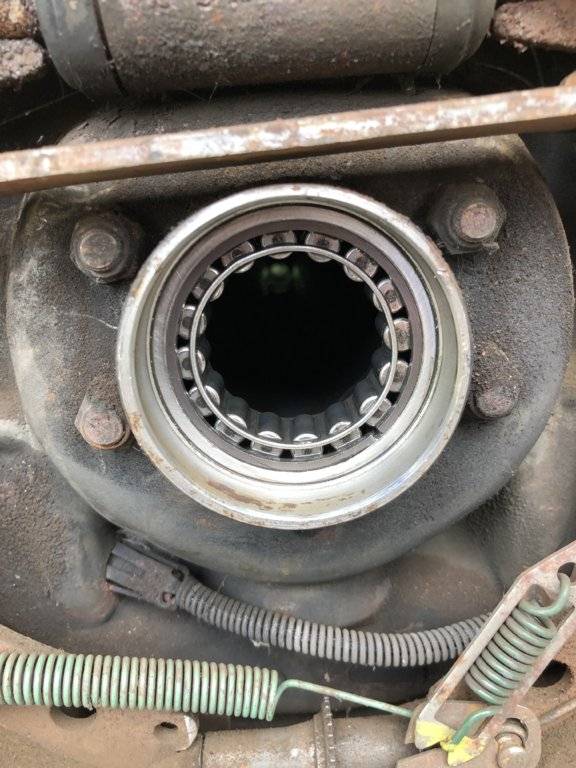

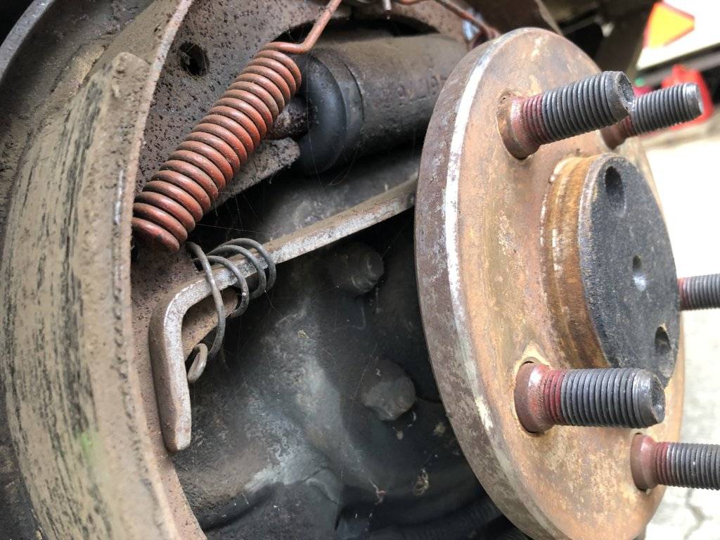

    When I went to go look at this fury the only thing I was told was “ 1970 fury 318 solid car” and I was surprised when I walked up to it seeing it was off the road for so long. But once I hooked my truck to it and gave the car some power everything worked and the engine wasn’t froze up. She spun freely and we pushed it up to the flat bed. The emergency brake still worked. Once I got it I started with the basics and a couple hrs later it fired up but wouldn’t idle more than 1 minute or so. Next day I tore the carb apart gave that a good cleaning(now rebuilt) changed out the fuel filter and the gas tank was bone dry when I got the car. Mixed up some marvel and gas and she stayed running. Next was the brakes. I had zero pedal at first but I had fluid. The master cylinder was plugged up and so was the passenger side brake hose. Once I cleaned everything the brakes started working. The drum shoes are stamped with Chrysler symbol and all the adjusters worked freely which blew my mind. I do have a growl in the rear (8.25) I changed out the rear wheel bearings and fluid but the noise didn’t go away. The transmission shop said my piñon bearing is making that noise. (Diff rebuild soon). She has a sloppy front end that I’ll be changing out along with the exhaust. I’m bringing this party barge back to life!!!

    Welcome and what a great looking car! Just curious...what kind of mileage do you get with the 318? You should be able to find a good used 8 3/4 to put under that thing.

    Go for an 8 3/4 and you have all ratio chunks available.
