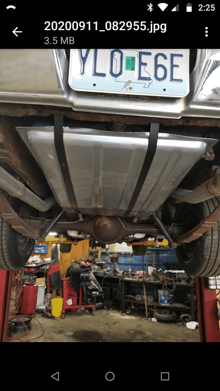

In case anyone was wondering, a b body gas tank fits a c body with little issues.

The b-body tank fits very good with no problems, and the price was right. Even came nicely painted.

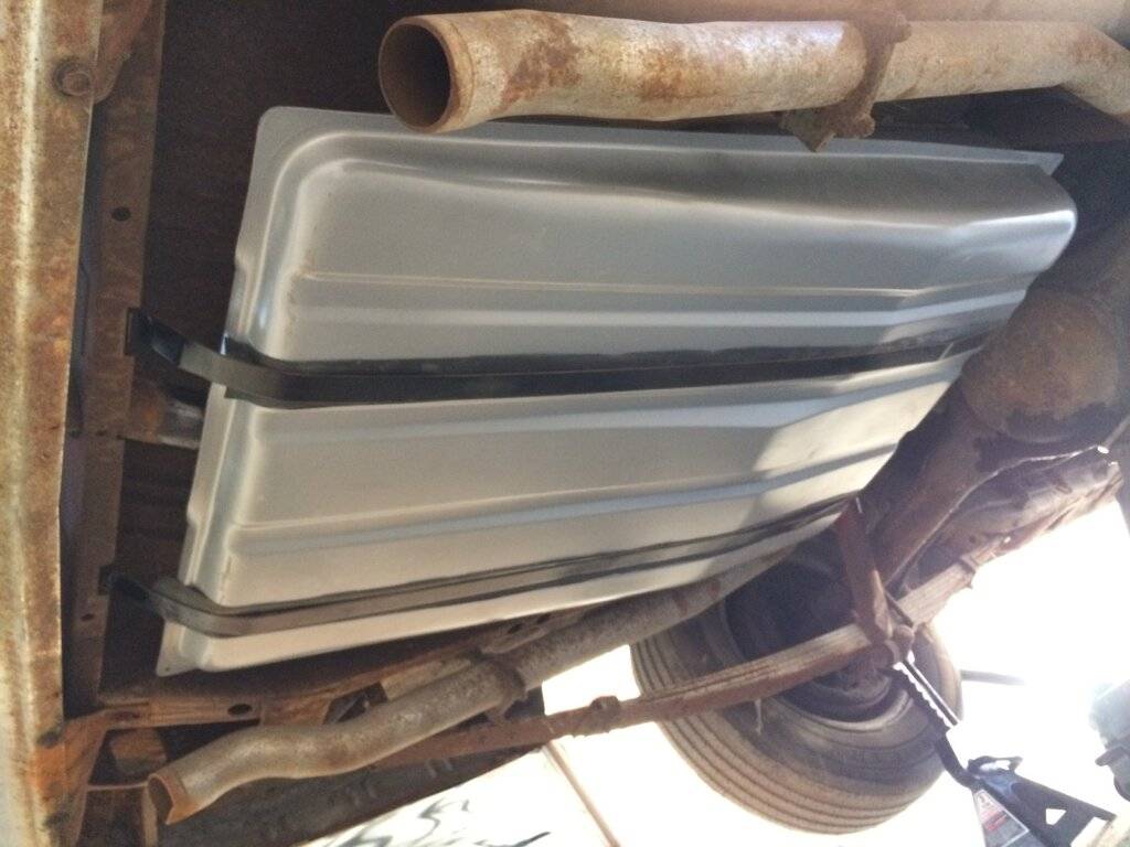

I remembered I had an old rusty 69 GTO tank sitting in a parts car, so I cut off the filler neck and it fits well in the rubber grommet. But of course the filler is fighting going in the grommet now that the tank is mounted. Next I will replace all the rubber fuel lines and filler up. I'm happy with this tank.

C-body line is 5/16. Sender has an additional 1/4 outlet, I'm thinking I will just plug that as there are already two vents on the tank and no return from the fuel pump. One last thing is that the original c-body straps fit perfectly, the tank is more narrow than stock tank.
