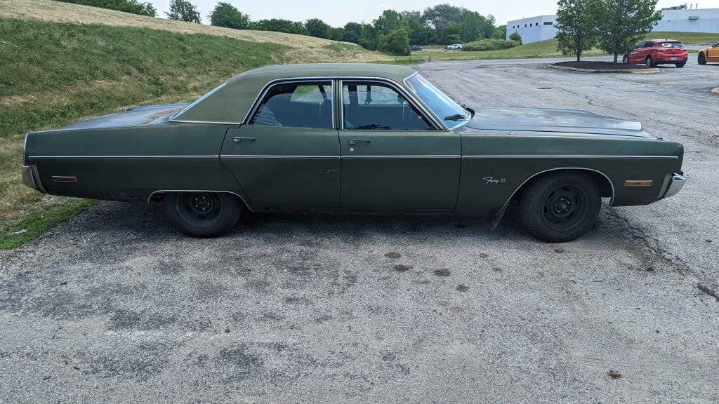

Anyway this is it the mean machine the green terror of the deep. Did I happen to mention that I've come to love this car in the last 6 weeks?

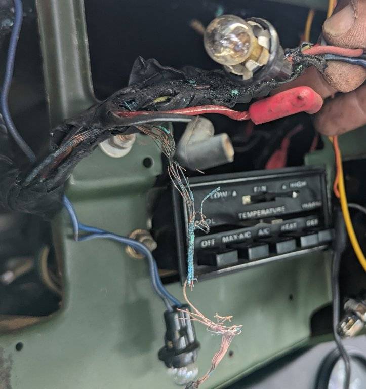

Thats some serious nuclear meltdown in the wiring.
Best to search for a harness from a parts car or a car thats about to be derbied and harness is not important, lol.

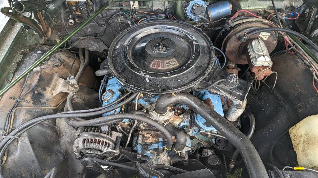

Those are decent compression numbers for a 'used' engine - I presume the red numbers are after adding oil to the cylinders?

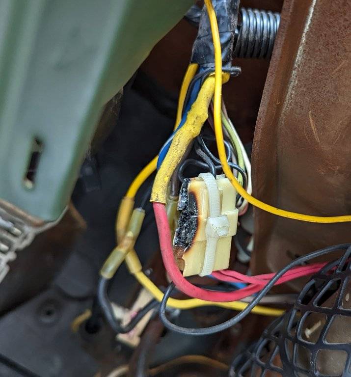

Melting at the steering column connector for battery and ignition power is common in 1972/1973 c-bodies in my experience.
What wire burnt in the dash?

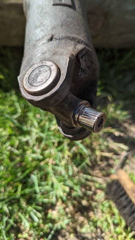

Serious brinneling on the u-joint. Good catch.

One wire meltdown from somewhere behind the gauge panel toward the heater assembly didn't burn through any other wires it doesn't appear but the burnt the insulation off of that one wire beginning to end apparently I didn't even find where it started stops at

I was never able to pick out what wire it was. Never found a shred of insulation to guess a color. Never saw where it started I couldn't find where it ended. On the dash end it had a female Spade connector.
There's been a couple real bodge jobs behind the dash in that car prior to my owning it

The black and red numbers are hot and cold. Hot is in red no oil added. I'm in DeMotte 2hr north of Indy right off east of i65

What causes that formation on the ujoint cross? My guess is lack of Grease getting wet and sitting all at the same time.
Yeah, looks like we're right at 2hrs apart. Too bad it's not closer.
On the U-joints - they don't travel through range of motion like a wheel bearing, they only rock back and forth. I don't think the needles ever make a full revolution. Those grooves then happen due to dry grease or lack of grease as driveshaft torque tries to flatten them. A dry wheel bearing would self-destruct because each roller moves, they never stay in the same place/position. U-joint needles just dig themselves a small rut.
The range of motion then probably decreases as the leaf springs flatten, as that reduces driveline angle.

Lack grease causes brinneling. The u-joint needle bearings grind into the cross, instead of rolling on the surface of the cross.

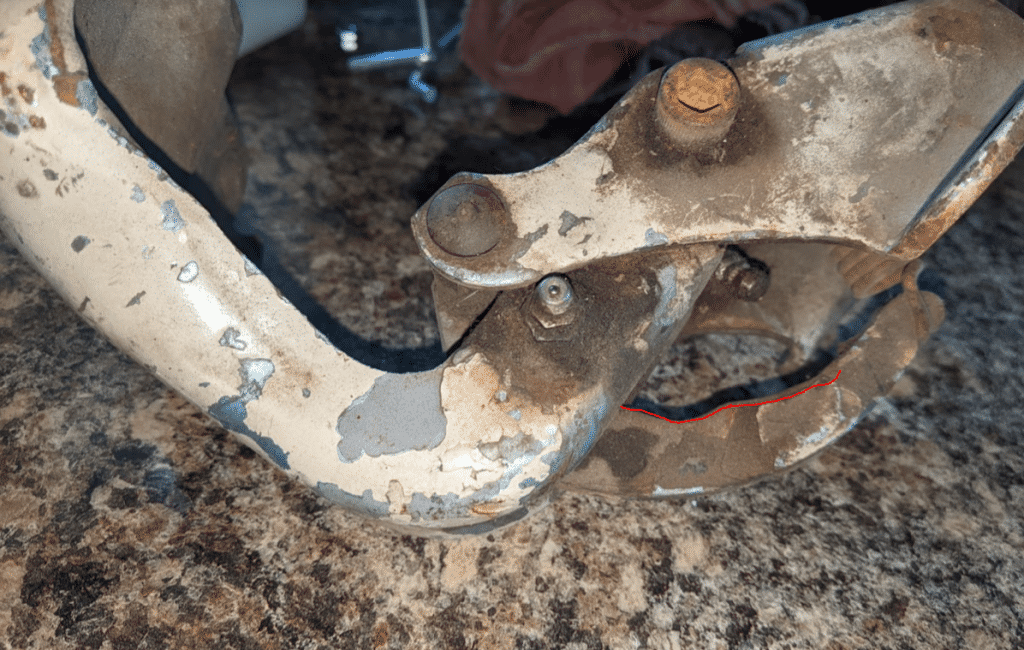

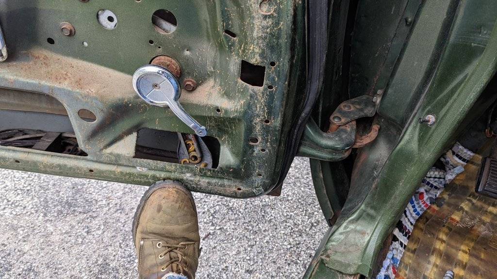

Window cranks the match. I'll buy one I'll buy a pair I'll buy triplets or quad. Price dependent I suppose. But anything will be considered. Window lift bushings or rollers if that's what they're called. This driver side window is a disaster. And last but certainly absolutely not the least the spring that helps hold the door open.
If anybody knows where I can find these things or has these things I may purchase please please let me know ASAP .

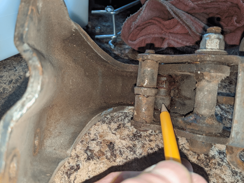

Is the metal roller still in your hinge?
In these 2 pics, it is located at teh grease fitting (this hinge has been modified).
Pencil points to it in photo 2.
The roller often seizes to the roll pin it rotates on, and may have a flat spot(s), and the roller-arm often gets worn also (the red profile line). The spring holds the roller-arm against the roller, and the profile in the arm gives the door-stopping location. When the flat spots are too great, or point in the arm gets rounded, the door is less likely to stay open, esp if car is facing uphill.
Although it is common for guys to replace the hinge pins and bushings, the roller/arm/spring are generally neglected.
I'm not sure if that pin and roller are still there. I have not noticed it. There will be a closer examination this evening.

ksc, you have quite a project there! The body looks solid (accuracy of my assessment limited by looking at the business-card-size pix on my iPhone). Glad it’s gonna be saved.
