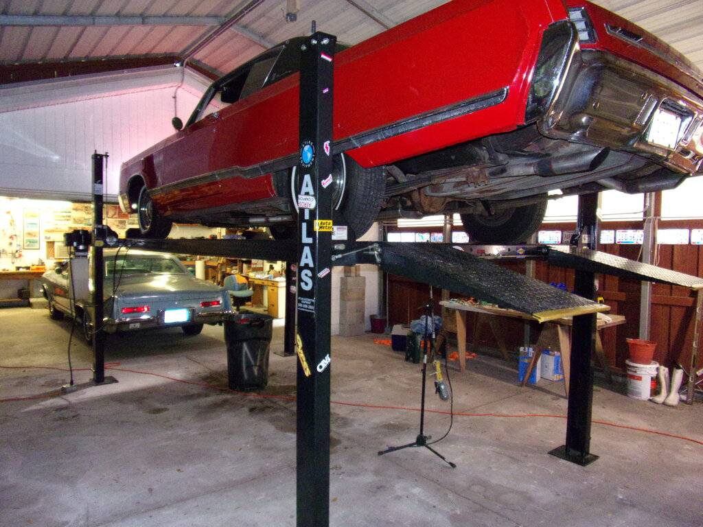

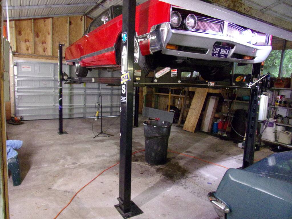

Hello Gents, I just got a 4-post lift in my "compound" and so far it is awesome. I bought it gently-used off FB Marketplace for $1800, and did the install myself with the help of my lovely wife. Now that I'm under the car, I'm cleaning underneath, marveling at how clean the car is for an Ohio car, (only light surface rust underneath) and thinking about changing out the differential oil.

Well said! It seems as though everyone is assuming it is a Chrysler 8 3/4 rear end, which is understandable, as it is the most common rear end on our beloved C's. However I see a Riviera in the background, and I'm not sure, but the red car looks like a '65 Buick special? Or wildcat?

I'll add one more thing, check the seals after. I had mine changed not long after the initial purchase and it was the original oil. It must have been down some since it started leaking out the seals that must have dried out. The outers are fairly simple to change but I had to do one inner and had to take that shaft to a shop. Congrats on the lift too! What is the inside height of your compound? Looks like an 8' high door, maybe 4' above that? Curious, I'm looking at building one now.

Regarding the lift: My ceiling is 13 feet, so that allows me to raise the Riviera (or Newport) up high enough that the lift runways are at about 6'6". That is more clearance than I need to easily walk under the thing, and more than I need to work underneath.
I will need to raise up the 7' door so that I can lift a car and also store another car under it. An that's the plan, to get another car to store under it! It's a disease as I'm sure you're all aware.
