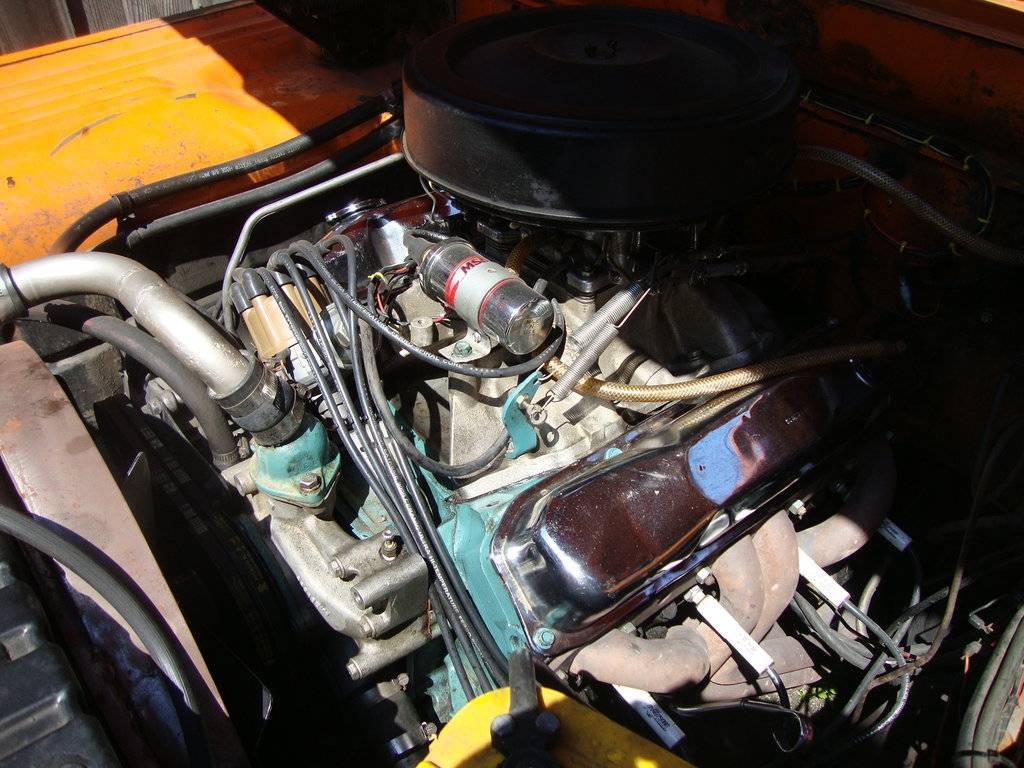

todays gas and heat raiser passage under the carb is an issue . i've been blocking them off and going to electric chokes on my four bbl cars . and layering gaskets and thin metal spacers between them under the carbs to hepl stop heat transfer from the engine . one solid spacer doesn't do the same as muti layering .
me no run advance with this dizzy , but the chrysler electronic dizzy does vac off the carb . msd mounted inside for a cleaner old school look .
