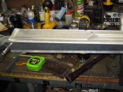

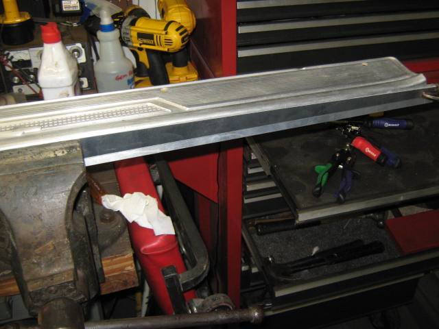

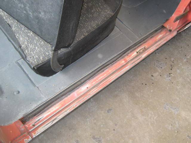

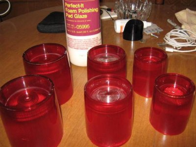

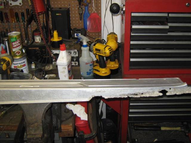

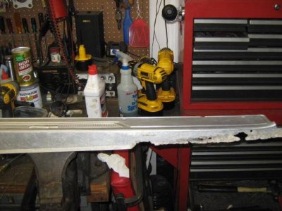

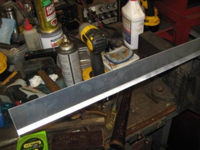

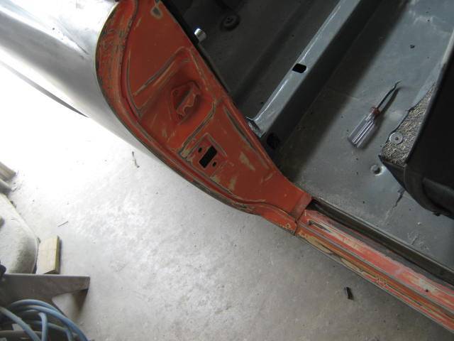

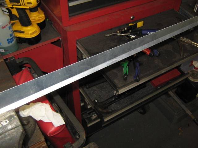

Today's tasks included polishing tail light lenses and repairing the aluminum door sill plates. I used some 3M polishing compound and the tail lights cleaned up very well. My drivers side sill plate was really corroded on the forward vertical part. I tried to find some replacements, but $$$. I ended up taking a piece of .038" aluminum and making overlays for the old door sills and put a small bend on the lower 3/8" like the original. I haven't decided if I will use rivets or adhesive to attach the overlays, but I leaning towards the adhesive.
I saw an ad on TV for Gorilla glue. I think I will buy some of it and see how it does on some scrap aluminum first. If it performs like Gorilla duct tape, I will be using it.Thats a good idea for your sill plate restoration Bill. The sill plate from my 61 Fury are in about the same condition. I've not had much luck locating any so I may try your idea. I think adhesive would be he way to go also.

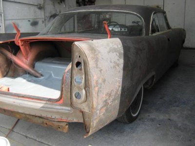

Tail light lenses look good. I got lucky and located a NOS pair.
I agree, good stuff...I've had good luck with JB weld. It's a great all around epoxy. Once cured it should never come apart on a fix like that.

Regarding the the gorilla glue.... It expands as it sets which may not work for your intended purpose .... Good for some things, sand able, paintable, cures with humidity and great on wood.
