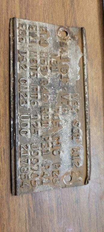

Hello,
I hope can find some help on a couple of C body projects
1, Can anyone decode this data plate?? I am in need of interior stuff and SMS fabrics need the code

CodeDescription
E86440-4 Barrel High Performance
D32H-D A-727 TorqueFlite Trans / Some Years A-998
CM23C = Chrysler
M = Medium
23 = 2 Door Hardtop
UOCU = 440 375HP 1-4BBL 8 CYL
0 = 1970
C = Jefferson Avenue, MI, USA
217854Sequence Number '217854'
EW1Paint Code: White / Alpine White
M6T3Trim Grade/Style/Color
M = Medium
6 = Vinyl Bucket Seats
T3 = Light Tan
FT6Upper Door Frame: Dark Tan Metallic / Burnt Tan Irid
125Date Built: 1 / 25 / 1970
J99705Order Number: J99705
EW1Roof Type OR Color: White / Alpine White
H53Single Air / Temperature / AC
R43Unknown At This Time
R31Duel Rear Speaker w/ R85
P31Power Windows
P41Power Door Locks
L31Hood / Fender Mount Turn Signal
P45Power Deck Lid Release
C16Console w/ Buckets
P28Power Seats Left and Right
B41Front Disc Brakes Some Yrs. Power
G12Tinted Glass Side
V78Accent Stripes - Delete
V39Unknown At This Time
S61Tilt Telescopic Steering Wheel
A12Chrysler 300 Hurst

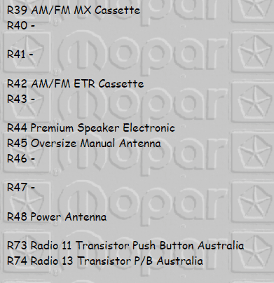

@Sport Fury 67 — thank you for decoding the fender tag. Loaded Hurst!
One correction: H53 is AutoTemp which (through the 1970 model year, 1971-1973 is better) is a real pain to fix and unreliable.
Also: I think I read R48, not R43. If I’m correct then CM23U0C217854 has a power antenna.

Interesting Hurst. S61 Tilt, C16 Console, H53 AirTemp, and P41 Power Door Locks. And this elusive R code. It looks like a 46, but there is no 46 listed anywhere, including the Wise and Red books. Is it a 48 or a 45? I'm going with a corroded 48. Maybe we'll find out from the OP if it has a power antenna. I have only ever seen Tilt and Console in Hursts, so this leads me to believe this car was actually ordered by someone (or dealership), not just produced and sent to unsuspecting dealers.
No R46:
Which is what I suggested :poke::lol:
PS: a power antenna (R48) also makes sense, given the car has virtually all the other power options.

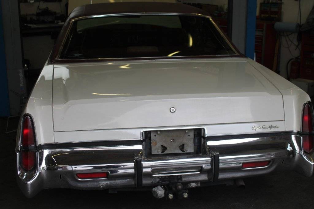

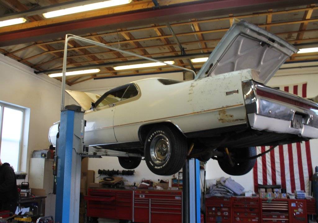

@Bob with one O — can you share some of the story of the 1970 300 Hirst?
CM23U0C217854
OMG, where to start...My Boss found this car on Ebay in Berlin as a last car that he would buy and its my job to make this car perfect as possible. The car came from California, but it seems that it sat outside uncovered for many, many years. The odometer showes 29k and I believe this is correct. From sitting outside there is MAJOR rust issues and someone tossed in a halfass interior over the rust. Yes the car does have a power antenna and that is something I need to find. But overall the car is worth fixing. All the outside trim is there but a few of the interior plastic pieces are missing or broken from the hackers that did the interior. Items Shared on 1-23-2023 I attached a link to the project. There is some pictures of a 1971 New Yorker that we are using as a donor car to fix the rust. As soon as I get the Poland pictures off of my phone I will update . Greetings from Germany, Bob
