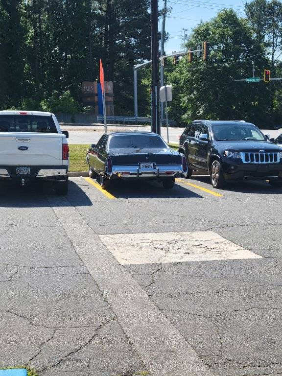

not as glamorous as those Miami pics. I also need to find a parking brake release lever and a spare tire.

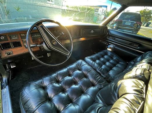

I'm new to these, so i dont know option from standard. Its got the usual. AC, cruise, power everything. Regular climate controls ( sounds like there was an upgrade offered) sport wheels.
Looking further, i have the button tufted leather seats in black and the St Regis style vinyl top.

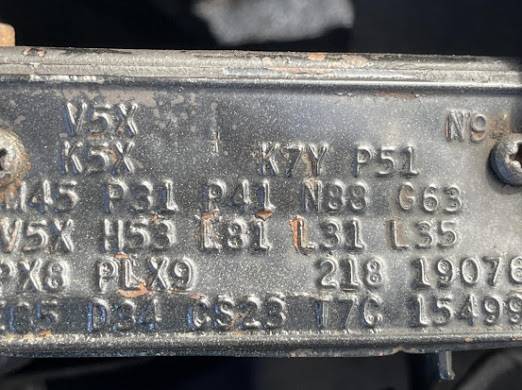

Remove the rear seat and see if there is a broadcast sheet between the springs and the foam, if there is remove it very carefully and scan or photo a readable image up here, you will be a very popular site fan if you do that.
(that sheet shows all the build options)

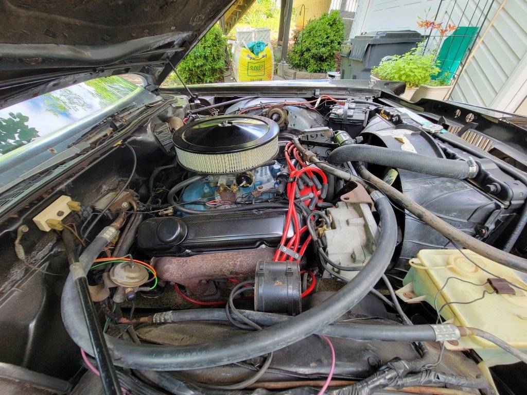

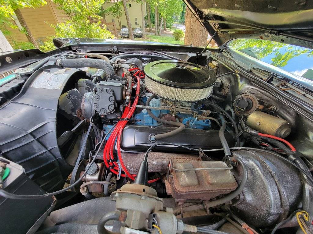

Follow up on the AVS2. I've been thru most of the systems. I sealed off some vacuum leaks, changed the plugs. Each step, it runs a little better. Carrying a solid 15" of vacuum. Then i tackled the timing. It was set at about 18 degrees, which was part of the problem. I tried the default "start at 12d" i read on here, but no better. So, with some advice from my brother, i set up the vacuum gauge and tuned it by ear, retarding until the vacuum drops
. Its now at about 6 degrees and doing much better, but not quite smooth yet. I know its a 440, but this isnt the kind of car where the engine should shake at idle. Might look at replacing the JDM Speed ignition for something better. Also set the accelerator pump linkage to the leanest setting. (The installer upsized the jets, which may have been a mistake.) I need to follow thru and make sure they also upgraded the needle and spring.

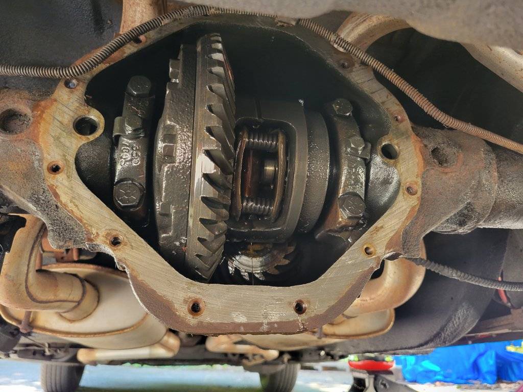

Otherwise, the car is doing well. Still makes some alarming drivetrain noises, so i'm still looking for a shop to get it up on a lift.
