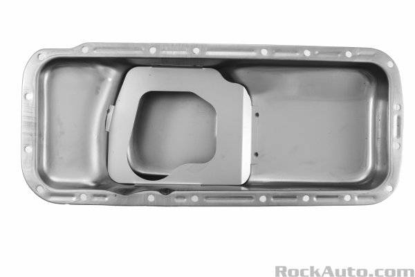

With the scarcity of 187 and 699 oil pans as well as the BB A body guys buying them up I've been looking for an alternative to overpriced beat up used ones. I've found 440 source has a nice deep sump baffled pan for ~ $250, but I'm not really looking to lose any ground clearance these days. On a lark I checked rockauto and found they have a stock looking replacement pan by Pioneer, #501172, and it's already baffled.
So was wondering if anybody had tried one and could share their thoughts on it?

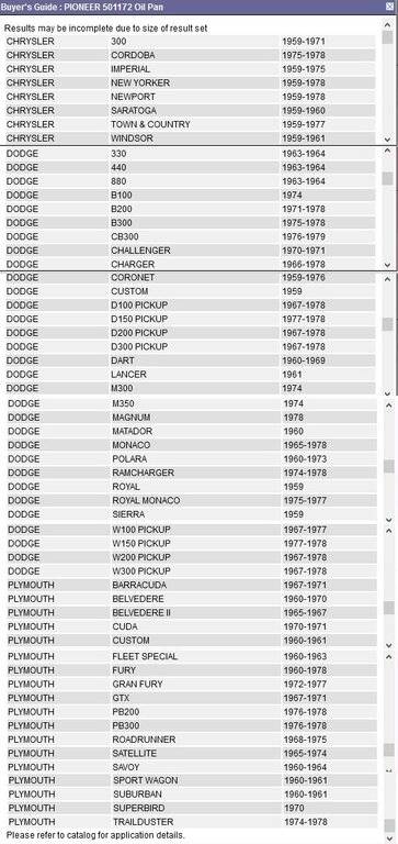

Pioneer lists that pan as fitting just about every big block Mopar ever made, and even some cars that Chrysler never made. I would be surprised if it actually does fit everything without interference issues. The only way to know for sure would be to try one and see. It's clear in the photo that it doesn't have the idler arm relief that many B, C, and E pans have.

I don't know where I got the idea it had idler arm relief, but you're right, the pic doesn't show it. You won't be making any right turns without the relief in a '65 to '73 C body. I guess I got hung up on the front profile where it clears the crossmember. B body pans won't clear that.

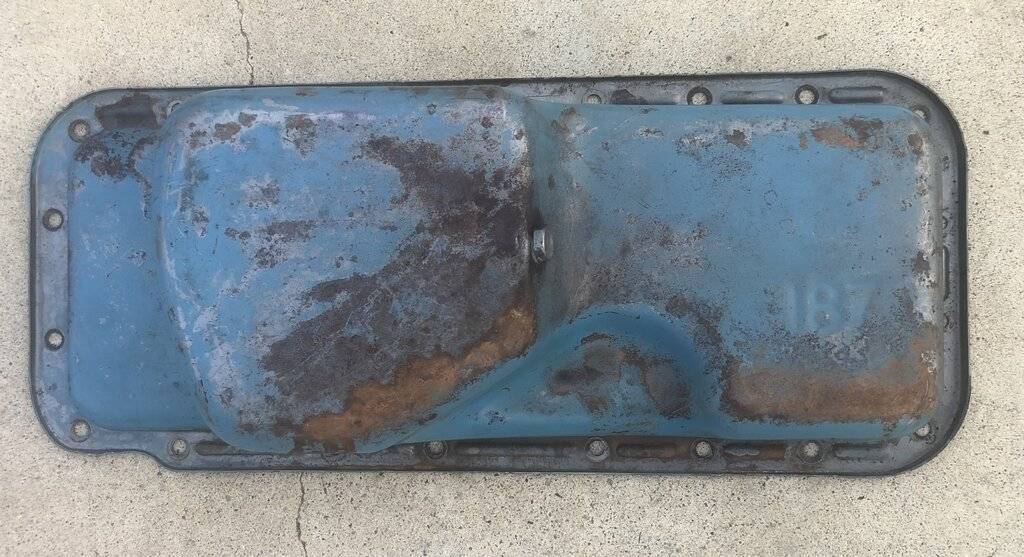

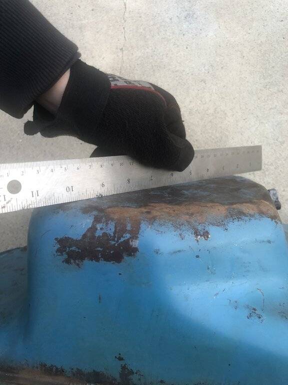

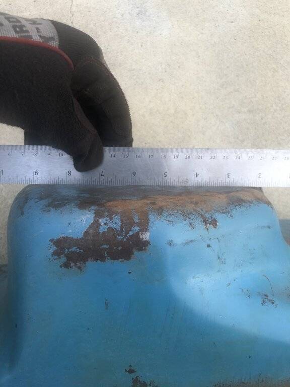

They’re still out there. I just sold a nice 699 pan yesterday and I still have a 187 pan for sale. With pick up. It’s very straight. Zero rust. $120 plus shipping.
