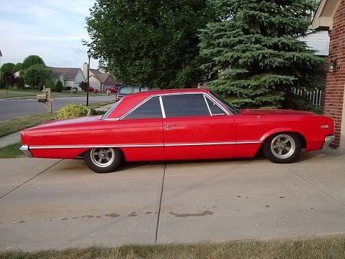

I did a color change. I also told the shop I wanted a well done job, but also to keep in mind it was "just" a '65 Polara.....not a hemi cuda. $14,500 got me from point A....
To point B.......
Obviously there is a point "C" next, as the car is not done at this point. I had the car completely stripped minus the body side molding and front and rear glass. All trim, badging etc was removed by me, all side glass and interior I removed. He did pull the sub blasted and painted it. Pulled the dash and painted it. All interior trim that was metal he painted. The bottom of the car is staying original. He did also spend quite a bit of time on the body side trim. He got the dents out and polished it. Labor is expensive, but I wanted it done right and not have to redo everything at a later date. Sure is a hard pill to swallow though.
