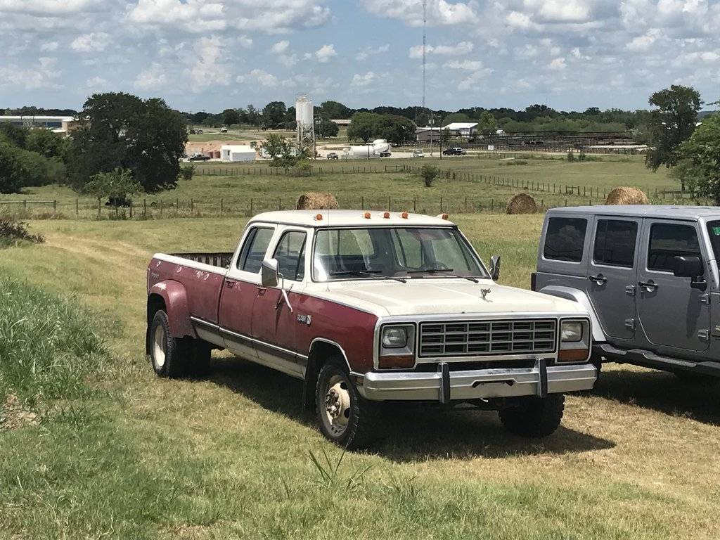

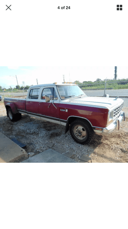

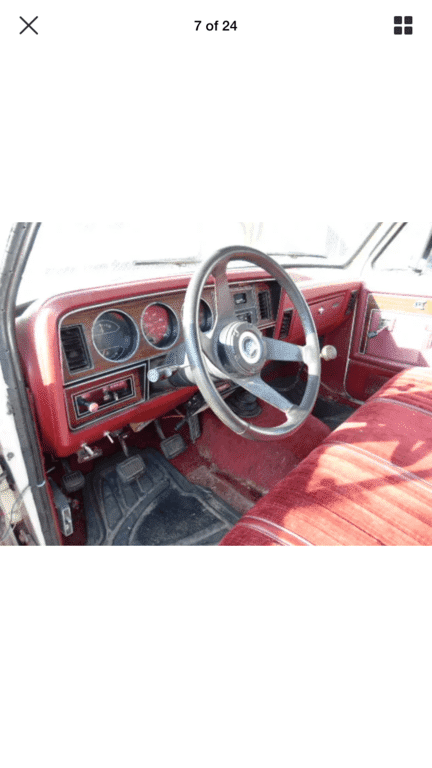

So I recently sold my 1969 Chrysler 300 as I was looking for a different project. The new project is not a C body , but still a mopar. I have always enjoyed this website and forum as it's members always give good advice that is not just a bunch of BS and the content is helpful. So I figured I'd post here anyway.
Just picked up a 1983 D-350 crew cab dually with a 360 4spd. Truck needs lots of tinkering and work, but it is rust free and inspected. Drove it home last night and just ordered my FSM. 360 runs strong, but there is a vibration at 65mph that makes the tranny really start to shake. Truck has some old bias ply mud grips on the front end that probably need to be replaced. Truck also has a worn out motor mount in the passenger side. Here are some pics. If there is a good Dodge Ram forum I would appreciate someone pointing me that direction.

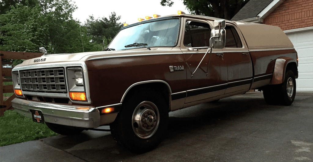

Sweet truck! I still want to get one sometime down the road.
There's ForTrucksOnly.com but it's slooooww compared to here, and a lot of regulars are already here on FCBO. Another way to get parts/info for your truck.
Thats a pretty nice truck. That would be a good candidate for a hemi/six speed swap. I always love this truck style.
Great project, like Locu suggested check out FTO and start a build thread. Lot's of Mopar guy's there because we all seem to have come from other For only sites.

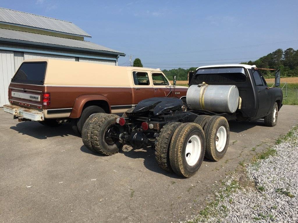

Thanks for the help guys. Wile E Coyote nice truck!

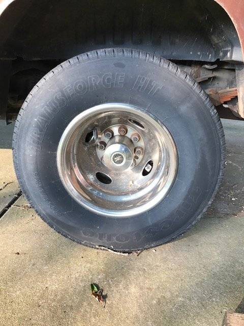

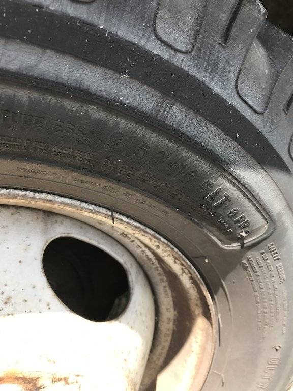

Do you still have the 16.5 wheels or did you change over the 16 or 17 inch. 16.5 tires are only made by firestone in one size and cost $140 a piece. I was thinking of picking up some used dually rims with tires that are 17s, but I really dig the original look etc.

I'm actually a little surprised to see 16.5s on an 83... they were phasing out even then... you would have less aggravation with 16 or 17 wheels... and might find some takeoffs that still have usable tread if you watch CL and EB. Don't forget the spare...
the newer dodge 350's have 17's . but their ten lug as well . stock 16's non split rims should be fairly easy to come by . ford rims can work , the locating pin is in the wrong place . dodge's , ford's , some gmc's , hi's used a larger rear axle hubs then chevy's . so machining would be required to make them fit . i did it to some alloy alum rims , needed @ 1/8'' larger reg hole in the center . the eight lug pattern is the same . and through the locating pins away .
