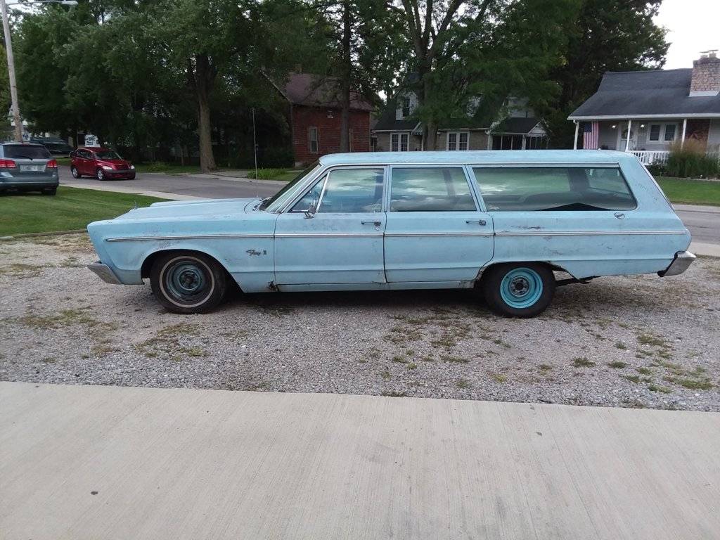

Got me a wagon
Start off with a good cleaning.
Will get diskbrakes in the front will need some parts .

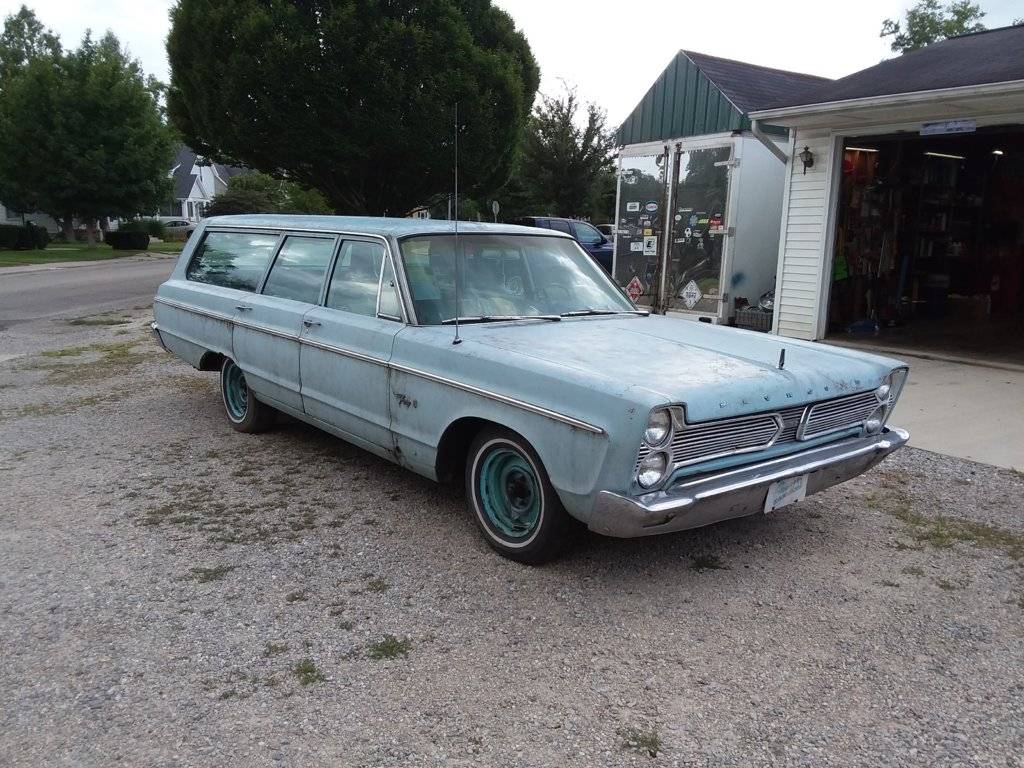

66 fury 2
Looking for disk brakes for it

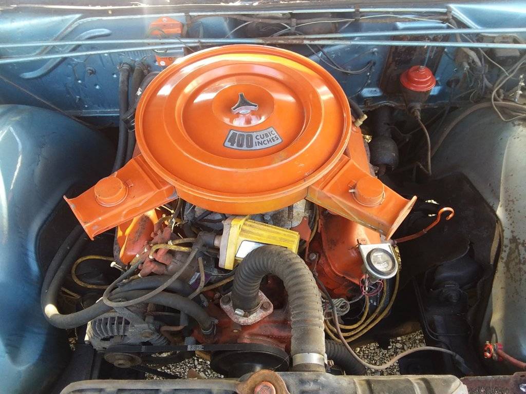

Personally, I like that air cleaner where it is. That Accel coil might find a better place to be, though.
Points are good, so long as you can get the dwell readings to basically match the point gaps. Points gaps first, dwell readings second. Mopar conversion kit would be my choice, as it's OEM-based rather than otherwise. Upgrade to an OEM-style, later vintage voltage regulator, though.
