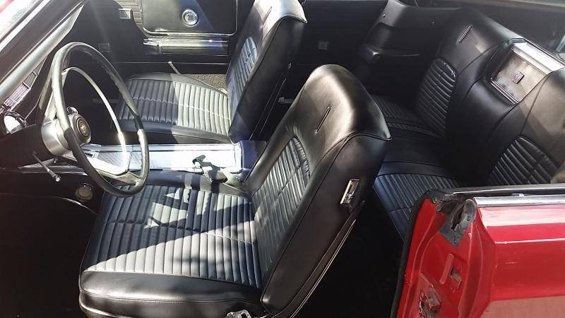

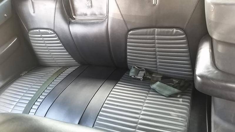

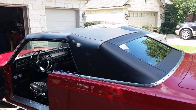

20150904_160555.jpg20150904_160608.jpg20150904_160619.jpgAll done. I love it. Now very proud to take the 300 out. Top came out perfect and the seats are amazing. Since everything is new now doesn't smell like rat pee anymore! Well worth the investment!!!
Wow wow wow. Beautiful work quality work. Wish my top looked that good, but it is never up. :)
Thanks guys! I'm just sitting in a 98 degree garage enjoying it. The top has had holes in it for 20+ years and the interior was shot. My 94yo grandfather who is the original owner is so excited to see it. I'm thinking of shipping it up to ny from tx so my dad can take him for a ride in it. She has come along way from a car that was buried in crap and abandoned for 18 years. The guy did an amazing job, handed me several numbers from people that saw it and want to buy it. I kindly said they'll have to pry my dead hands off this car. It's like Christine, except not even lol. The better she looks seems to really come more alive.
Really sharp, congrats!
