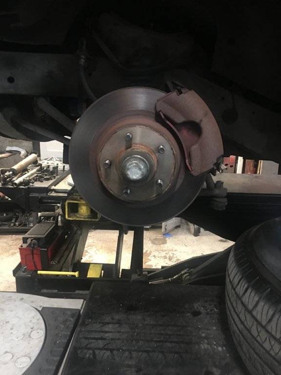

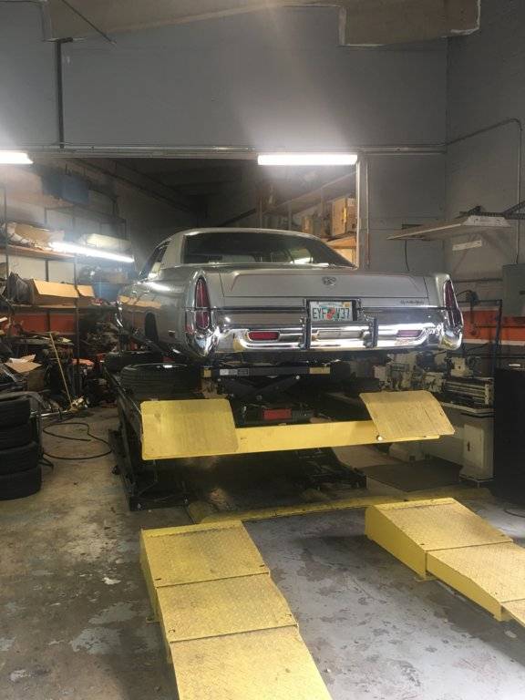

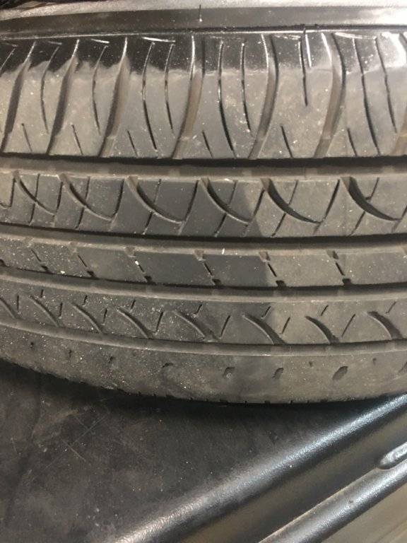

    Took the Nimitz in for some work on the rear brakes (been banging on application figured the adjuster was out of sorts). Also I’ve been noticing some excess slop in the steering and some uneven tire wear.
    So....
    Up on the alignment rack/lift she goes...
    Sure enough... adjuster cable is slack and adjuster is stuck (both sides). Shoes look good though. Take it appart, clean it up, lubricate the adjuster and see if that does it.
    Front pads all good.

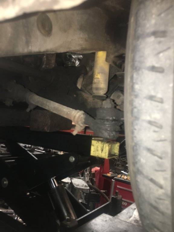

    Front tires wearing on the inside. Check alignment, set camber, check the upper and lower control arm bushings after new tire rods are in. If all good, reset the alignment.
    The front tire rods are all varying degrees of “toast”. As is idler arm. No wonder it felt so sloppy. Interesting is that it didn’t pull and the wheel held straight.

    Was the toe-in "towed out'? Or was the camber negative? Brake pull is usually a function of un-equal caster, than loose/worn steering linkage items, IF it's not due to a brake situation on one side of the car.
    When the idler arm on the '66 Newport was needing replacement, I'd noticed that the front end was more sensitive to longitudinal pavement ridges than it had been, plus some clicks, AND that I couldn't follow BMWs through some off-ramps on the freeway (this was back in the middle '70s).
    I suspect you rotated the rear tires to the front?

    None of the typical noise of popping at standstill while turning. Quick check shows camber is out amp the bottom but upper and lower bushings show some cracks in the exposed part of the rubber but.... No looseness or movement. May have dodged a total rebuild on the front suspension.
    Now toe in or out with the level of looseness in the tire Rod joints.

    Tires were wearing on inside due to toe out caused by worn tire rod ends. Upper and lower bushings good. Rotated tires and reset alignment.
    Rear brake cylinders were sticking and leaking and were replaced. Adjuster replaced due to lack of smooth operation after cleaning and lube of old adjuster.
    Diff seal changed. Replaced oil soaked exhaust hanger and cleaned up the mess.
    All new shocks including rear air shock. I am ditching the idea of a vacuum operated pump and reserve for a small electric unit (probably from a Cadillac) in the front and switch off the rear suspension. Still working it out. Separate post to follow.
    Car rides smooth and reacts well to dips and bumps with less upsetting of suspension. I hadn’t even realized they were gone but can really feel the difference with the new. Much more precise in handling and road manners.
