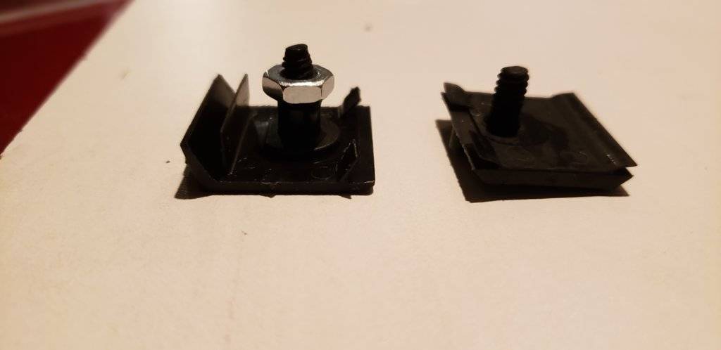

New trim clips, by the Lens Guy

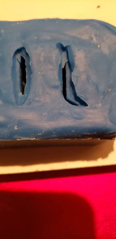

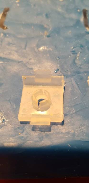

I am certain this mold will work. To remove the clips, I had to make 3 cuts, but the mold is thick enough and the clips are small, that the mold just closes back up.
I will throw a rubber band around it when I pour. It was good I had only 2 clips, I think it would have be difficult with more in the mold.
Scott your clip is still pristine, it should be placed under glass in a climate controlled environment, it could be the only one in existence. :)
Victory! Glad to hear it worked out, Mike! To think, I had about 10 or so more in the same condition that wound up on my car.

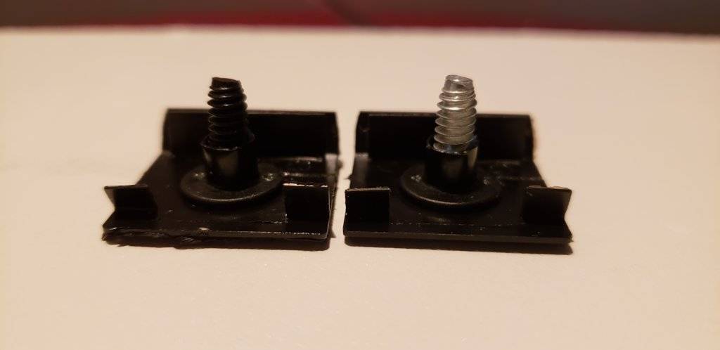

I sort of had success. I under poured the mold and I believe I may have made poor selection in my choice of location to make cuts to remove the clip.
The good news the nut threads perfectly on the clip and the black dye looks great. The concept of a threaded solid urethane clip is a success which is the most important part.

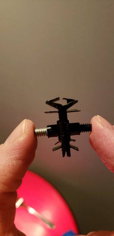

Wow, great work! I was thinking that even if you cast the black plastic part and reused original metal studs, that would be useful. When I was removing my trim, I found that the usual problem was the plastic part would break or the nut would be rusted to the stud and start spinning in the plastic.
I would resort to sliding the trim off of the clip, since the black clips are at the end of the chrome which is "open". Then I'd have to break the plastic part to remove the clip. I figured that the clip was already FUBAR once the stud started spinning in it. With a little coaxing to remove the nut, the stud could be saved and pressed into a new plastic clip.

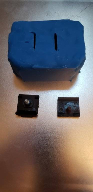

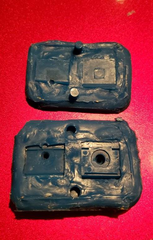

Success on the second mold, it was all about making the cuts in the correct area without damaging the mold.
I also find if I am making an open pour mold, additional urethane needs to pool above the finished product. When I put it into the pressure pot the product pushes further into the mold and it ends up being slightly under poured.
I am still worry about the longevity of the current mold so I am also making a squeeze mold. I realize now it would be the best style for this clip.

I should have just started with the squeeze mold on these clips. The clips came very easily out of the mold. I should be able to use them many many times.

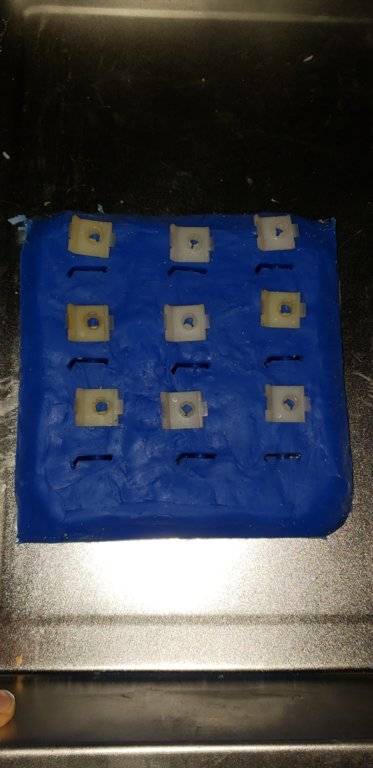

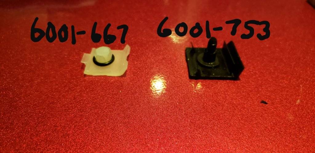

Thanks to @Mike66Chryslers for sending me 9 nice trim clips for the top stainless from his 1966. He sent them to me this summer. This weekend I was able to make a mold and reproduce these clips.
I will be offering these up for sale soon. I am going to track down some small O rings. I am pretty sure I found some plastic rod at Fastenal to use as the small push rod, when I installed my trim.
If I am correct these clips work on all 1965 and 66 models, to attach the top outside edge stainless trim to the body.
