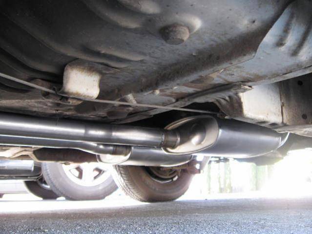

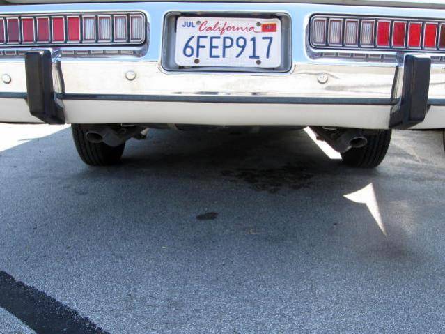

Then came new tires so I could get rid of the Chinese crap on the car. Now I could drive the car reliably so I was able to take it down to my muffler shop for their custom magic in doing a dual exhaust for me the right way. They actually let me get under the car during the work so the placement can be verified as far as direction and height are concerned. They have done 3 cars prior and this was a really nice job.

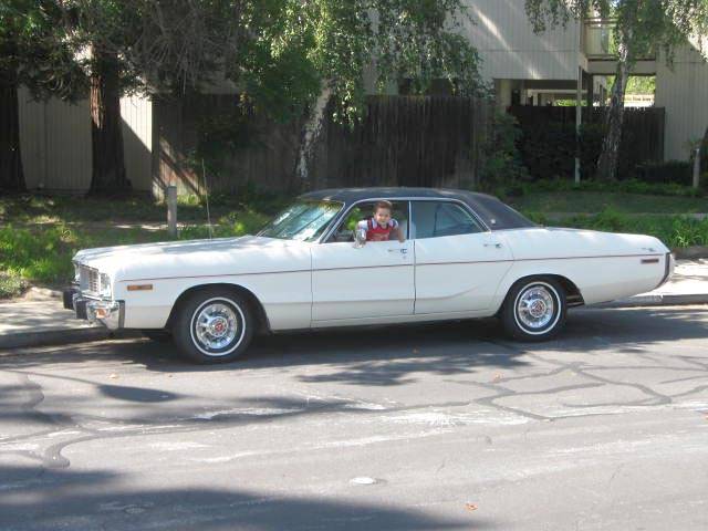

This is a shot before any body work. White is very forgiving so hard to see anything from 20 feet.

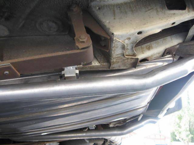

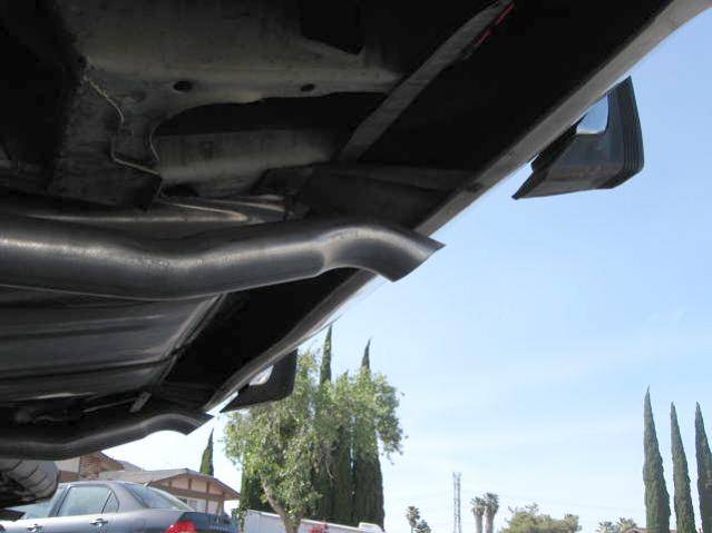

The exhaust was a pet peeve given how many use straight pipes out the back. Also many have a hard time getting the intermediate pipes tucked up under the car as they should be.
Nice, great condition .
Not many 73's being done...
Originally a California car?

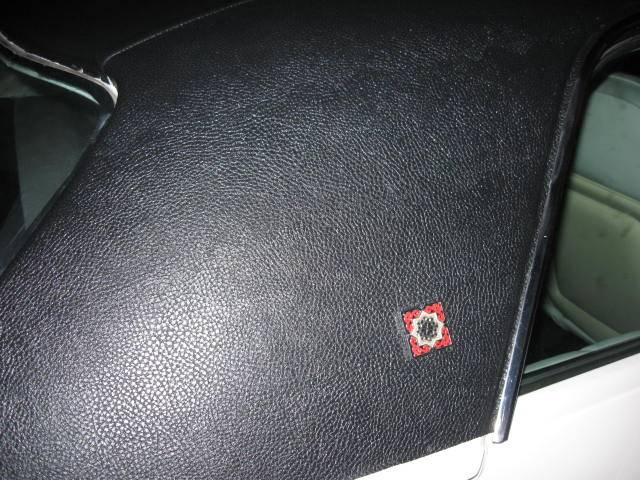

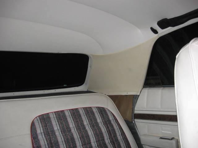

Wow, he was done today. Said the fitted vinyl top went better than he ever expected given the limitations with the drip rail still on. Then he said the headliner was the toughest one he has ever done because of the area around the sail panels with wrinkles. Picked the car up at 6:30 tonight and won't be able to get to the window trim until the weekend. Also need to source those narrow plastic clips that go in the narrow trim around the base of the vinyl at the back. A few preliminary shots. Headliner easy with flash while black vinyl top impossible with flash. Those plastic sail panels really yellow with age. You can see a small sliver of the original color at the very bottom before it gets covered up with the plastic cover from there to the bottom of the door.
Was this spot on the C-pillar where the emblem goes marked like this right from the manufacturer ?
Are those C-pillar interior sail panels plastic? Our '71 Monaco had ones that seemed to be cardboard covered with a vinyl paper of some sort.
I wonder if you could get a white vinyl dye or paint to bring those yellowed plastic parts back?
Those sail panels are plastic and almost seem to be two layers of plastic. Base layer being a smooth plastic base with the second textured layer on top. The reason I say that is the the pebbled textured layer actually peels/crumbles of exposing the smooth base. The guy who did the headliner says it is common among that older stuff. The best you could do was is to use a conditioner routinely to keep the plastic impregnated with moisture. That is what I will do and I will not try to scrub clean as that just causes the texture to crumble off. The plastic is also pretty brittle all around the interior. He suggested a product by Malco which I have to ask him about since they have many products.
The part that that has lost the most texture over the years is the panel in the middle between the two doors of a hardtop. My 1967 Park Lane has a similar panel yet the plastic is in great shape. It's sail panel is fabric over a base in it's case.
Have to say the plastic parts in my 70 300 also break very easily. Never had this with other manufacturers of that era.
