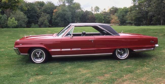

Both my Monacos came with vinyl tops, although you could order them with no vinyl top, in a contrasting colour, or same colour throughout.
I elected to delete the vinyl top on the turquoise car because I loved the colour. I left the little pieces at the tops of the A pillars just in case I decided to put the vinyl back on.
On my red car I will be restoring it with a vinyl roof. Too much red otherwise.
Either way, your car will look beautiful!
