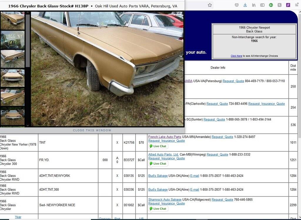

There's a '66 New Yorker in Oak Hill Used Auto Parts in Petersburg, VA. That's the only '65-'66 coupe that comes up on Car-Parts.com anywhere near NC. It's got a good amount of rust on it, so I wouldn't be surprised if the corners of the doors are rusted behind the trim.
