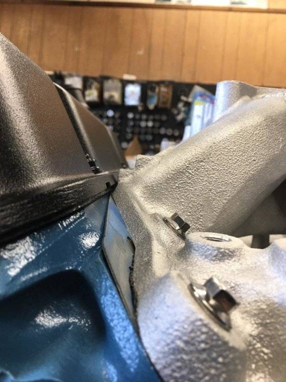

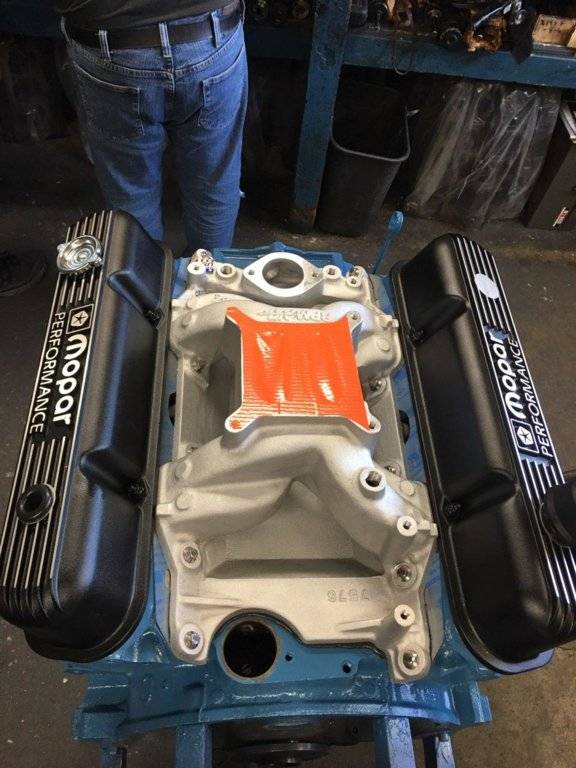

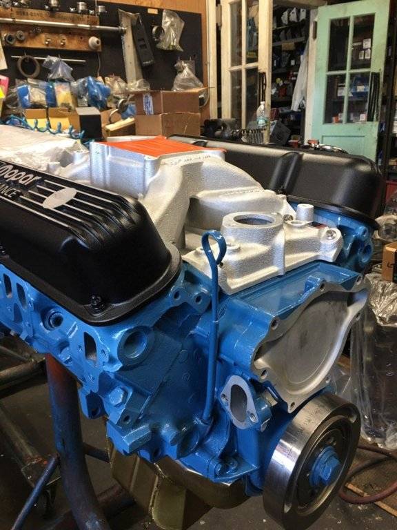

I was impatient and had a shop build my engine. Hopefully to accept delivery this Thursday ( fingers crossed). He sent me a pic of the assembled engine and I'm curious about so much intake gasket showing. It's a reputable shop , should I worry or ask anything before I pick it up?. Its a .30 over 360 Edelbrock air gap. Cast heads nothing too crazy.
you could always trim it, paint over it, or just don't worry about it
The intake you have supplied is a non-stock unit with a slightly different profile that a stock manifold. Gaskets are generally a one size fits all item. The extra material will not cause any problems.
Dave
Your after market intake does not have a heat riser passage, it would be a good idea to use an intake manifold gasket with this port blocked off so that exhaust gasses do not erode the manifold at the port for the heat riser. You will also need to block the heat riser to the open position as there will be not place for exhaust to go if the heat riser happens to close, would be best to remove the riser butterfly altogether.
