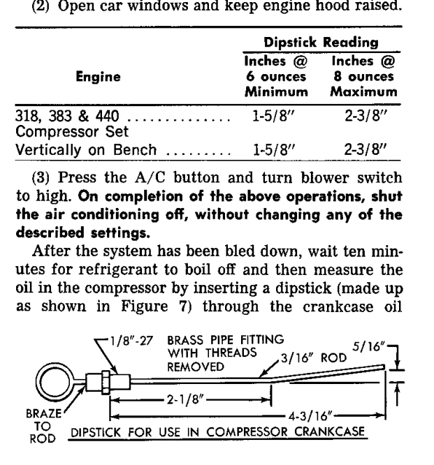

And the FSM shows how to make a dipstick to measure the level in your RV2 compressor.
