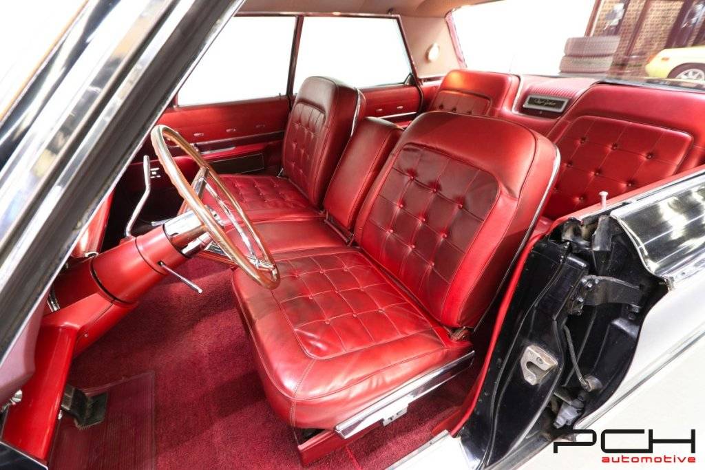

As to the seats, I WOULD verify that they were re-done in "leather", as some sellers mistakenly perceive that vinyl "leatherette" is real leather rather than just look-alike vinyl.
The seat insert pattern does match the factory New Yorker vinyl seats, but it does look like they have been re-done (at some point in time) in the factory pattern. Just that the individual squares in the online brochure I found at www.eatondetroitspring.com (might need to input that address manually) has more dimension to the squares, as in light padding under each one (with recessed buttons), rather than the as-presented "flat" pattern.
Additionally, for some reason, the front seat backs look to also be "over-stuffed". Especially compared to the "shell bucket seat backs" of the 1966 models. A minor deal, though. @Big_John might verify that, though, compared to his '65 300L.

Those seat backs look just like mine except for the ashtrays. All steel and painted to match.
Those seats look like the original vinyl to me. Perhaps something was lost in translation (the website being in French) or they just don't know the difference, figuring an upscale American car would have leather.

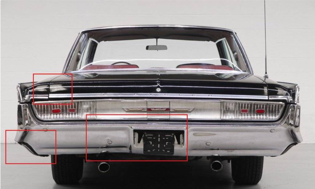

This is a nice looking car but the devil is in the details. Looks like the trunk doesn't line up nicely on the left. Maybe something happened there? Check that all doors open and close nicely. Check all gaps on panels for consistency.

@65Port Yeah, you're right — looking more closely at the rear photo, it does seem like the car might’ve been in a an accident. The trunk lid doesn’t line up quite right, and the rear bumper looks a bit bent. Doesn’t really look like something that would’ve come from the factory...
It isn't the deck lid that's not aligning, it's the trim. I also think the bumper issues are just shadows.
Either way it doesn't look right. Something happened back there. Looks like it could have been tapped on the left side of the license plate too. Need an onsite visit to see.

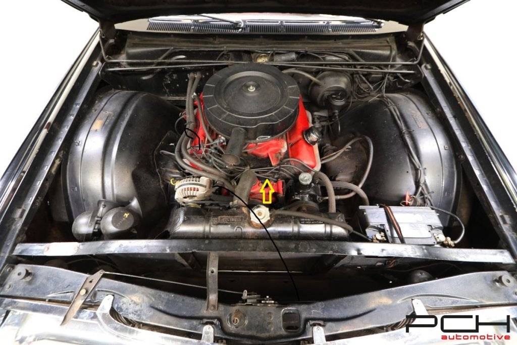

Would be a 413 in 1965.

Nice car. That rear bumper is certainly bent just left of license plate. Some of the trim is askew in the rear, but there likely isn’t anything seriously wrong. I would just be sure to check that closely in person.

I realize that. I am asking is that a 413 in the picture? I don't see the "boss" on the right side by the intake, and it looks too narrow.
RB motor. See the pad under the wires with yellow arrow.
So, probably a 413, but could be a 440.

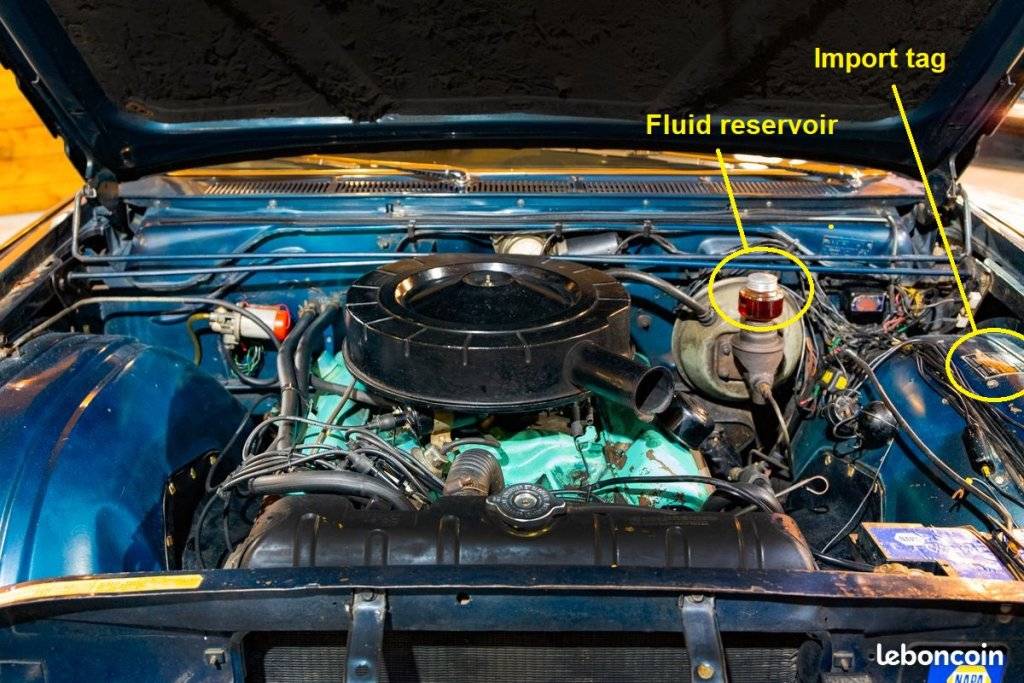

Based on the import plate, this car was most likely sold new in Belgium (I know of other Mopars sold new in Belgium wih the very same kind of tag). Cars sold in France would have had the "Chrysler Simca" import tag. I have pictures of that car from 2023 when it was for sale in Belgium. Also, cars sold in France would have the mandotory brake fluid bowl, that this one doesn't have.
From time to time, we can see those cars pop up in sales. I know of at least one other 1965 New Yorker sold new in France, and 2 1966s as well, that survived.
Pic of the engine bay of the French 1965 that I know of.
