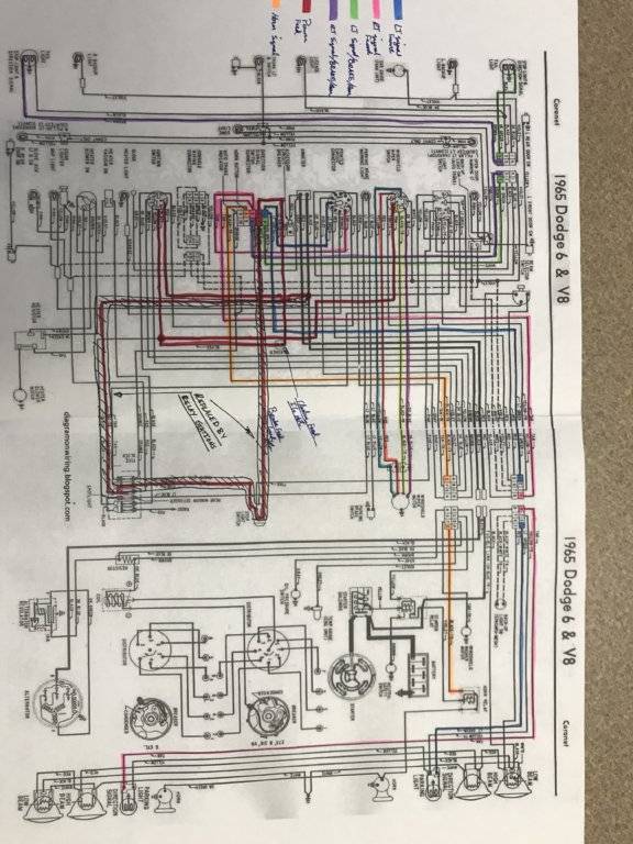

I'm not sure if this'll help, but here's a picture of a highlighted '65 CBody schematic (please forgive the crudeness, I'm using it for my own project). I compared this with the schematic from my '66, and even though the colors are different, the routing through the column connector is the same. I verified all the points with a multimeter, and the attached schematic is accurate. The resolution from the picture on here stinks, so if you need I can email it to you as well.
