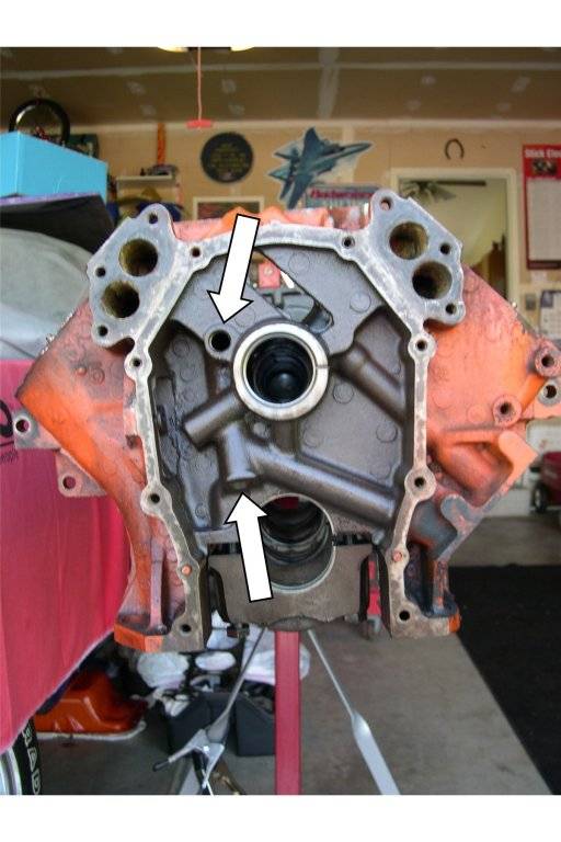

Be sure you remembered the front oil galley plug under the fuel pump rod. It's easy to miss....ask me how I know

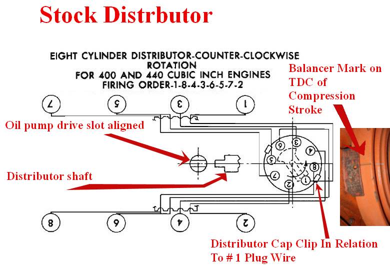

Seems like there is a particular relationship between the intermediate shaft and the camshaft involved that needs to be verified with #1 at TDC? Basically, whichever way the slot for the distributor drive is clocked upon shaft removal, put things back like they were prior to removal.

Yes, it's easiest to rotate it around like this before you pull the distributor and oil pump drive out.

Step # 4 = Using finger, check oil reservoir plug. NO PLUG (one facing down)!
Step # 5 = Install plug, spin oil pump, 75 lbs. oil pressure, oil circulating through entire engine.
