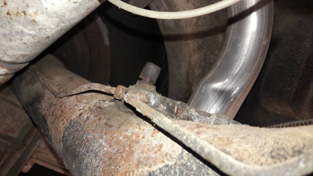

Here is a photo of the brass block splitter and the rear axle vent.
Think I found the fault (at least one of them ;) ). When I released the rear brake hose at this brass block nothing came out. Even tried to brake bleed but it was the same as before. Then I disconnected at the other end (at brake line from the proportioning valve) and it started dripping brake fluid right away.

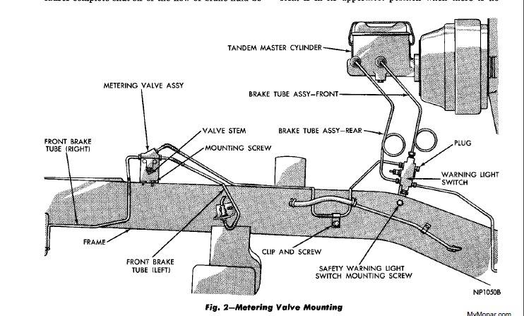

Glad you found the trouble.
Just as a little info, you don't have a proportioning valve in your '70. You have a warning light switch and a metering valve in the front brake line.
From the 1970 FSM.
If you don't have one, download a copy of the FSM here: MyMopar - Mopar Forums & Information - MyMopar Tools/Reference
From the 1970 FSM.

Thanks for info!
Yeah, my bad. I actually watched this video the other night when I started this thread. The word proportioning valve seems to be missused alot (just like I did ;).
