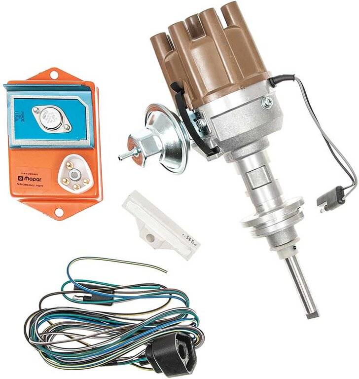

Are you really attached to the lean burn system? I would ditch it and convert it over to a Mopar electronic system like this one.
