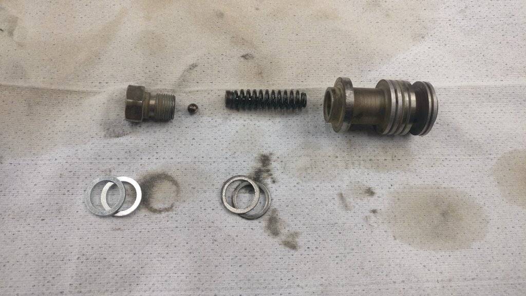

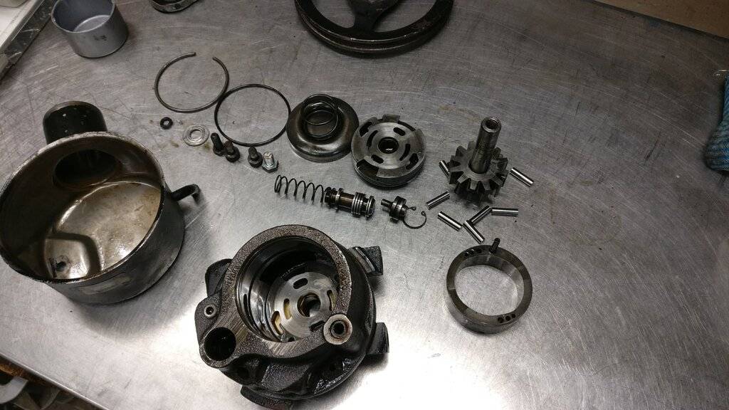

I took it apart and all the parts appeared to be in great condition. I did replace orings and seals
I also shimmed the internal valve to drop maximum pressure for less total assist. But this shouldn't matter when the engine is idling.

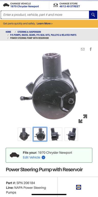

I saw someone mentioning new federal pumps at napa. But if i visit the website it says that the part is not available

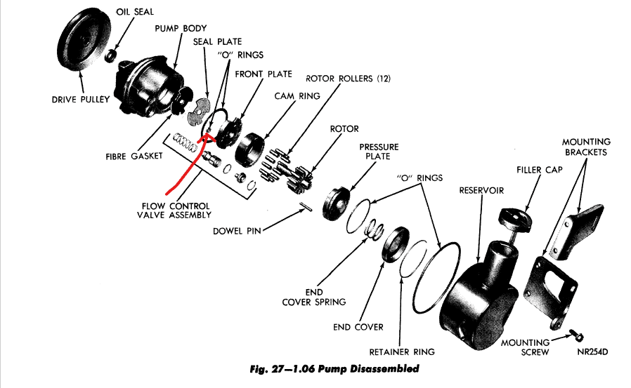

I remember my FSM mentioning something about making sure the fibre gasket and seal plate are aligned or it won't function properly.
I'm sure they are assembled correctly.

Sounds like it's not moving enough fluid around in idle but if it's not air and it's assembled right only thing I can think of is a worn rotor and I can't help with that.

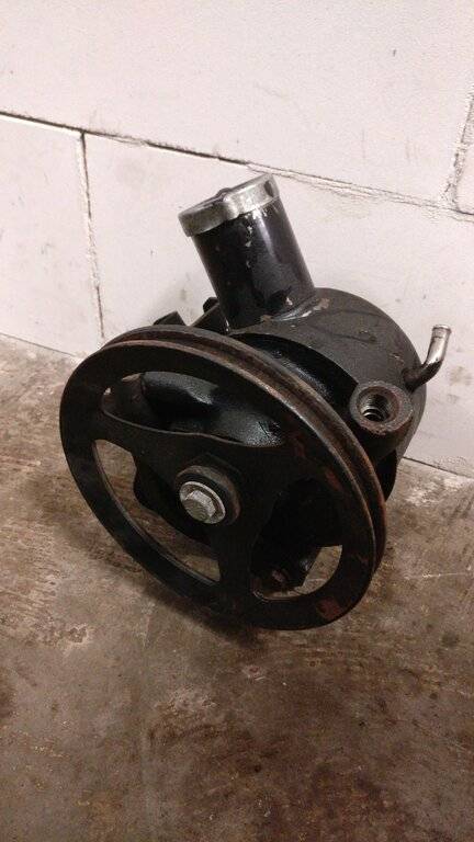

Is that pulley the usual size? It looks large to me, could it be failing to reach minimum pump rpm? Just a thought, others will know for sure. LC
My federal pump on my 68 doesn't look like that, mine is the 'solid' kind. Don't know the diameter right off, I think it's like 5"? Doesn't look like a 7" though.
The 7" open pulley I have is an original mopar part and seems to be original with some federal pumps. Can't find too much information on this though.
