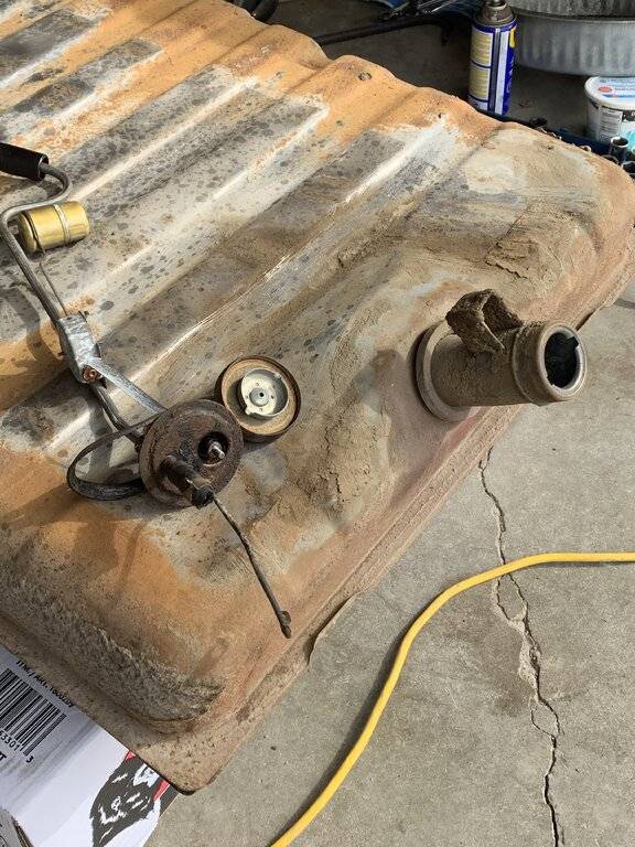

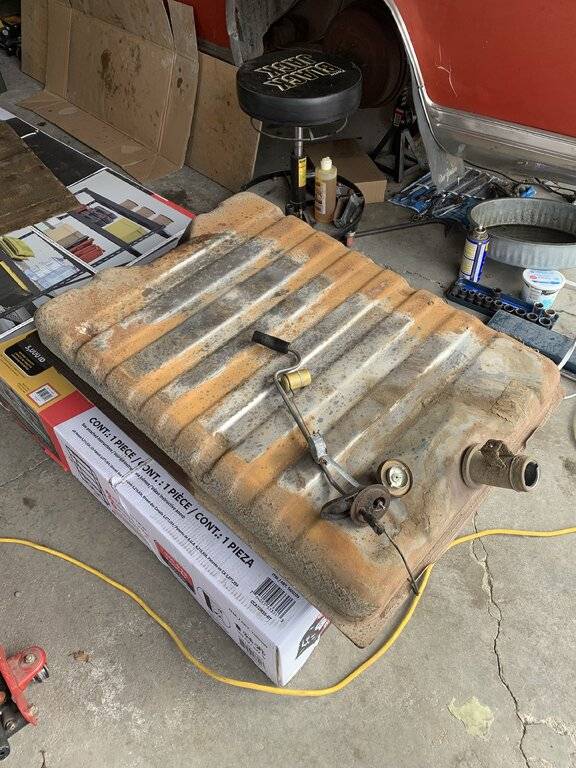

I just removed the gas tank to clean it out and I see there is no vent tube on it. I'm not overly familiar with venting systems on a '64 but I thought they did have a vent tube. I don't think the gas cap is vented. Any thoughts as to correctness?
'64 Chryslers did not have a vent tube on the tank. If memory serves me correctly, it should have a vented cap.

No internal rust on this tank just a 12"x8" patch of varnish down by the fuel pickup, not bad for sitting around for 18yrs, cleaned up nicely with some acetone and naphtha I had hanging around.:thumbsup:

Great info Ross, trying to find what a 1964 vented gas cap looks like, not sure what mine is.

The vented ones usually had a hole in the center of the bayonet lug like the one in your photo. The aftermarket ones were usually stamped "vented".
