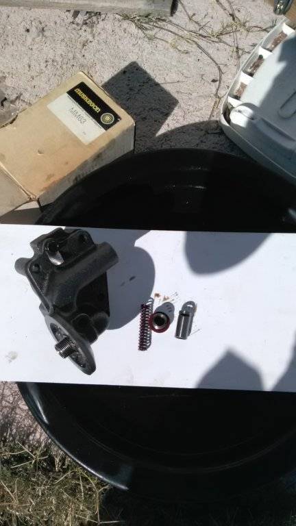

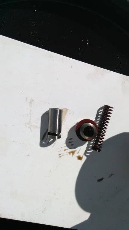

In broad daylight this morn, I replaced Mathilda's original pump, again carefully primed with Vaseline and all was back to normal. I noted that this Muskegon pump's pressure relief valve piston is fluted at the far end from the 7/8" hex head retainer, unlike the original, and it doesn't slide as far. I removed and examined this carefully, noting that the spring seems strong, as a "new" spring ought, and that the rotor indeed meets spec tightness in accord with the FSM. My Question now: Would a stuck pressure relief valve cause the noise when running, then the violent ejection of motor oil closeby that I experienced?
Note also that the piston in the original pump freely slides into the second chamber, allowing relief thus I surmise but is solid, not fluted. I will post pictures tomorrow since these certainly will provide more data han my damned prose since I plan to change my oil back to 10-40W for warmer weather to come and I probably will have to help the old pump a little w priming again.... Your thoughts will be appreciated. I know that my last oil pump quandary was allieviated by unsticking the pressure relief valve, and given how simple these pumps are, there doesn't seem to be much else that can go awry with them outside of wear.
