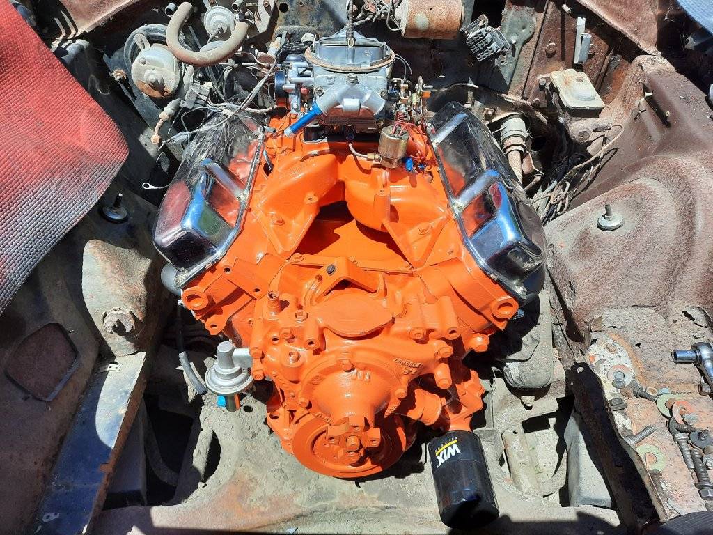

The clear gloss will ad an extra layer of protection to your newly painted parts. I went through a bunch of those cans when working on the rebuild was done on the 71 NYer a couple years ago.
Everything that I rattle canned, i.e. front suspension, torsion bars, as well as all painted engine parts, got a coat of clear gloss after the paint dried.
(I didn't spray the block, as it was painted with ceramic paint).
I also sprayed the ESPO springs, shackles with the VHT clear, and even the fire wall after it was painted with rattle can GY5 Crystal Dawn metallic to protect the finish, and because of the heat protection the product indicates.
Spraying everything with VHT was all done before driving to Carlisle and back to IL in 2020.
As you may know, I just got the same car back from the painter and recently wiped down all the paint dust that was all over the car from being at that shop for over a year, Everything including the under carriage and engine bay area, and can attest the clear coat is still holding up well after all this time.

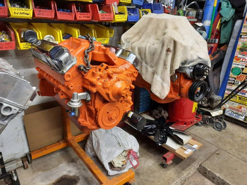

I spray all my engines and and use the clear as well. Never any issues.
