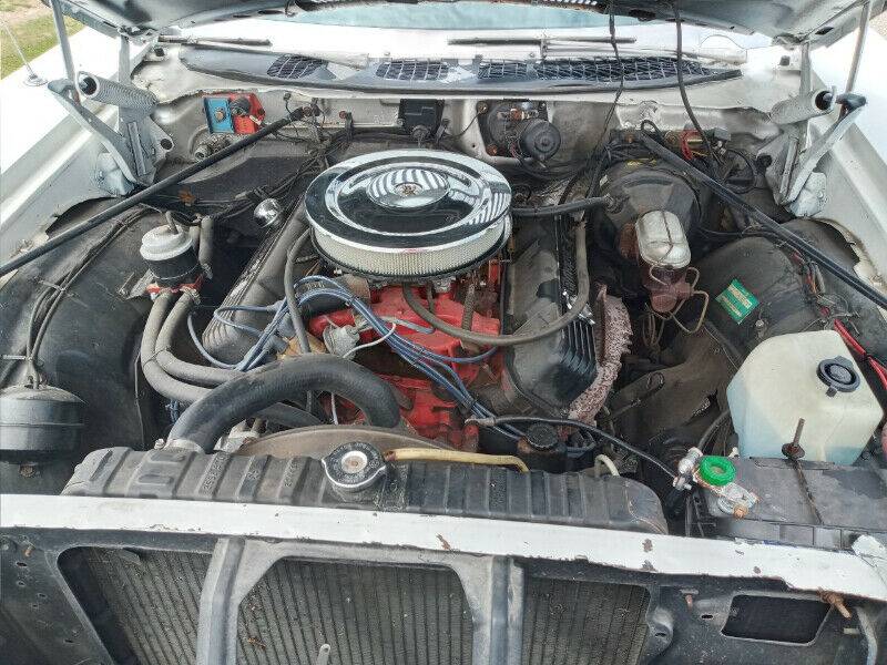

The are a lot of things that are not correct for this car. Engine if original should be blue not red. Exhaust manifolds are HP type, car should have log manifolds, aftermarket air cleaner and valve covers, appears to also have an after market intake. Missing A/C compressor, hoses, condenser as noted, probably means that the evaporator is toast. Center caps for the road wheels are incorrect, incorrect custom seat covers, missing exhaust tips. Car has been repainted the wrong color. Seller admits to rust on the rear window channel and pinholes in the trunk floor. In short, this car is a project and not worth anything close to the asking price. Would also want to check the VIN numbers on the engine and transmission. Posted photo of the VIN says it is a 440/350 does not document option code for SFGT. Appears to have full power with buckets and console.

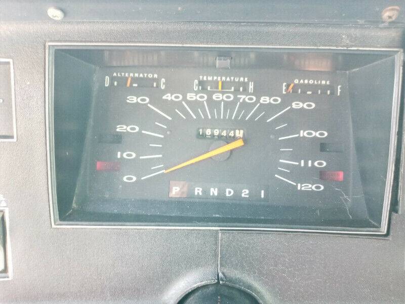

Marko is correct, the factory console cars have the gear position stuff blocked out because is shows on the console. One more thing to add to the list.

I know they used red on the bigblocks for a long time in Canada but don,t know when they stopped doing that ...........?

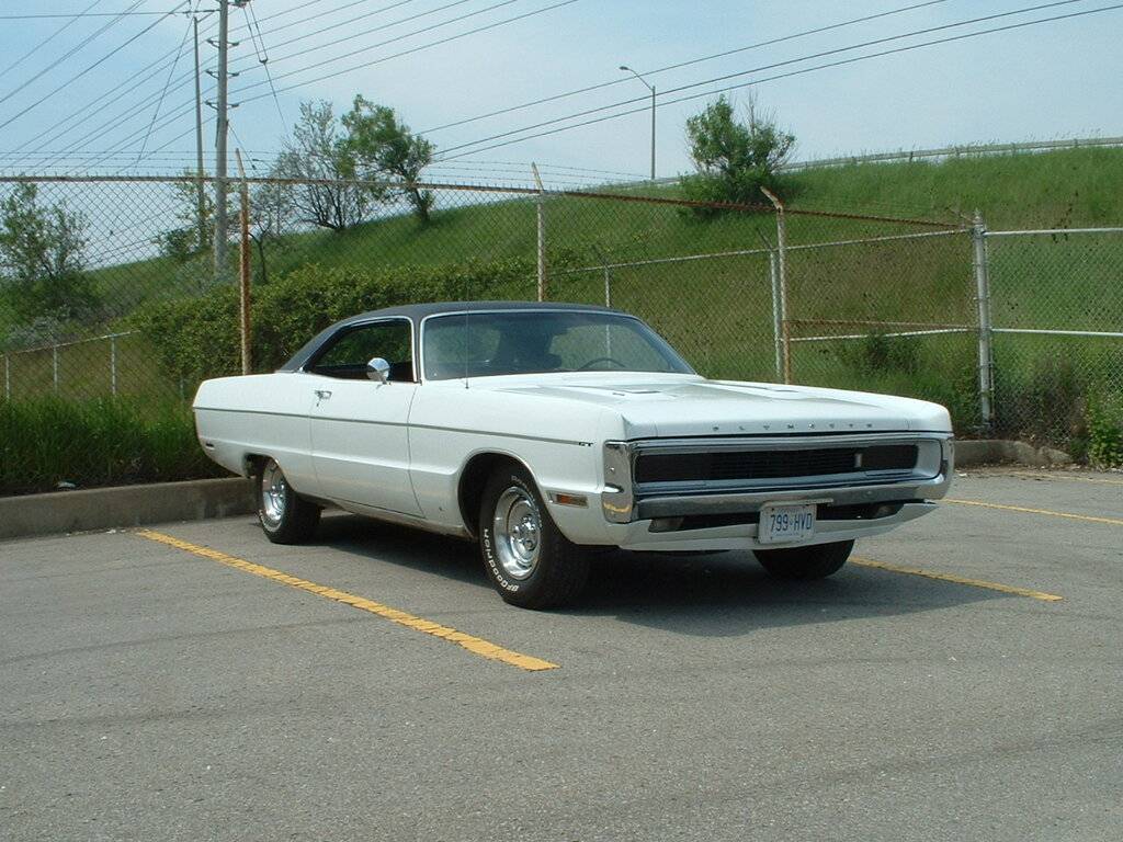

Was for sale 3 yrs ago. I took this pic June 21 2017. For the right price it would be a fun car but sure has deteriorated. I did speak to the seller a few weeks ago but I suspect he has good money in the car.
