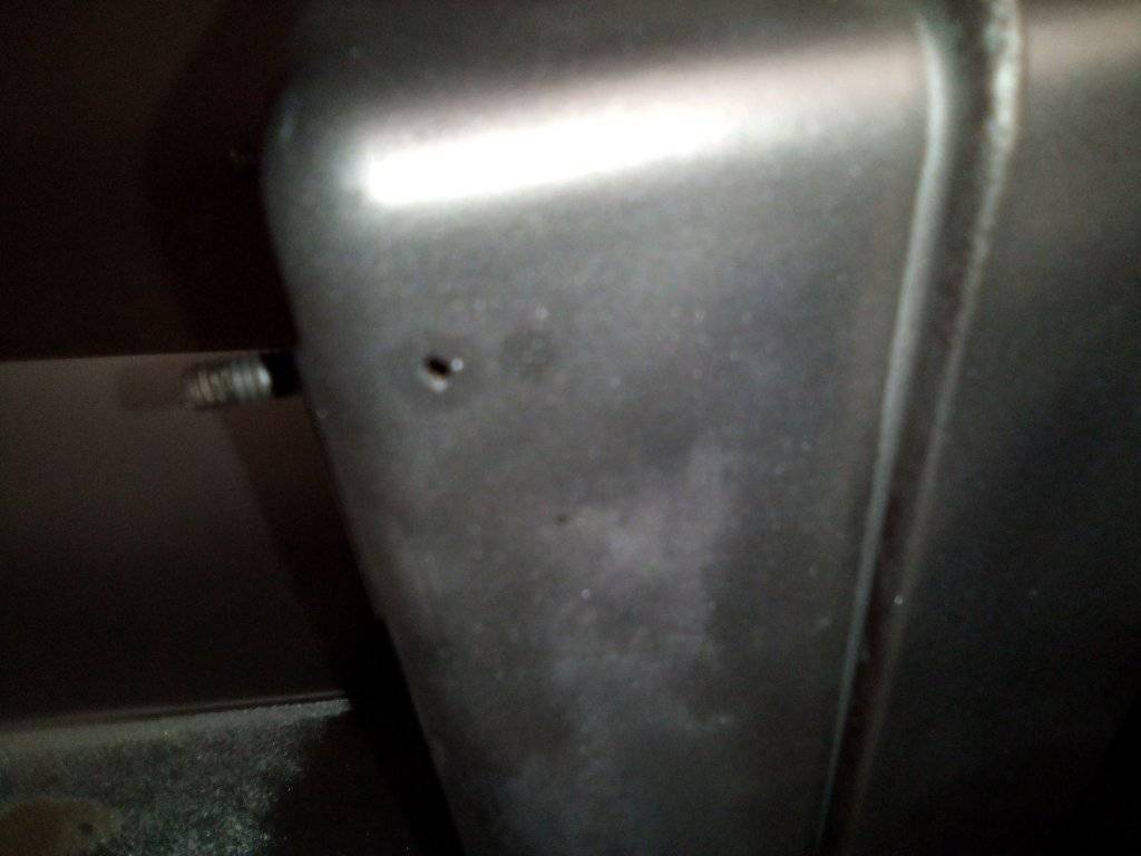

As some of you may or may not know, my other hobby besides cars is old tractors. I love them just like Mopars and have from a very young age. I unfortunately don't have any Mopars....yet, besides my daily driver but I do have a tractor I'm currently restoring.
The tractors gas tank has 2 small holes in it, one is like a tip on a fork if that makes sense and the other is a little smaller than that. I am on multiple tractor forums and one member on one of the forums says to use JB Weld to fix the holes, and another member on another one of the forums says to use a glaze and spot putty from AutoZone.
My stepdad says JB Weld is not really that good for the gas tank because it could crack over time then the gas tank will be leaking gas all over my new paint job when the tractor is all done and painted, so he technically says don't use JB Weld and that I want something that will last forever so bring it to our local radiator repair shop who also repairs gas tanks
In my opinion though, if I could use something like to JB or the putty stuff to fix it myself to save a little money on this project I would like to do it.
My questions are 1) is JB Weld OR the glaze and putty from AutoZone any good for my gas tank holes?, 2) should I use one or the other?, OR 3) should I listen to my stepdad and bring it to the radiator shop?
Thank you to everyone for their help in advance!

BEST long-term reliable fix would be "at the radiator shop" where they braze over the holes, file things down, etc.
JBWeld is a great product, but I'm not totally sure that it is "fuel rated". No knowledge of the AutoZone items, but if they are body repair related, NO dice.

Solder them shut or solder a small piece of copper over the hole. You have to tin the tank first so the solder will stick to it. Like CBODY67 said a radiator shop should be able to do it. There is always gas tank renew

I would solder both holes. The one at the filler should be able to be just soldered up, but the other hole will need some additional filler metal.
I have seen holes like that filled with a sheet metal screw and then the sheet metal screw was soldered to seal it. That made for a very good and not too ugly repair. Since you are doing a restoration, that's probably not an option, so a piece of sheet metal, maybe brass (get it at a hobby shop) would work. A little massaging with a hammer to bring it level with the surface and cover it with JB Weld, sand and finish.
I wouldn't use JB Weld as the repair. IMHO, that's a temporary type repair and will eventually fail. Great for the beater car that only has to last through winter, but not for a good restoration.
Time you learned how to solder anyway. My small butane torch, Stay Clean acid flux and 60/40 lead solder would be my weapons of choice. . But a propane torch and flux and solder from the plumbing dept at Lowes Depot will get the job done.
Clean the area, apply the flux, heat and touch the solder to the area. Now wipe the solder with a rag while it's still molten. That will "tin" the area and make the solder for your repair "stick". A little patience (the torch can get it too hot) and you'll have a 100% repair that will last. Clean the flux off real well (inside and out) with soap and water.
There's a bunch of videos on YouTube on how to do this. Search "Solder repair gas tank".

epoxy type fixes need surface area to bond...they dont stick that well so they need to cover a good sized spot ...and i think what you would have to build up to make a successful repair would interfere with the threads on the filler neck...brass could be ground back to the original shape

I do appreciate everyone's suggestions BUT I brought the gas tank to my local radiator shop today. It should hopefully be ready this Thursday, I told the shop owners brother that I wanted to fix it with JB Weld and he too said it is no good so I am very happy I made the right decision on what to do. I will try and post some pictures of the tank when it is fixed.
