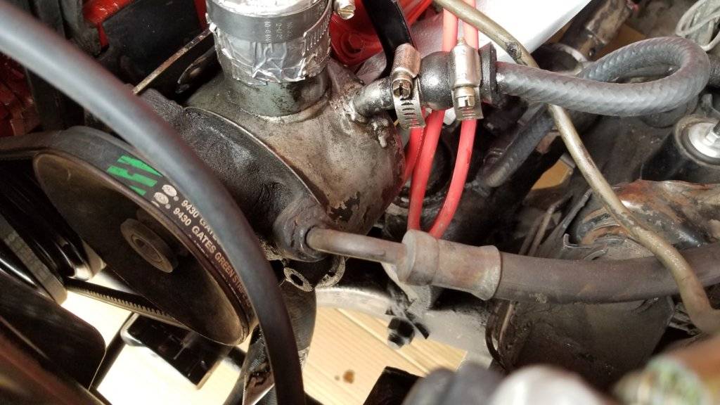

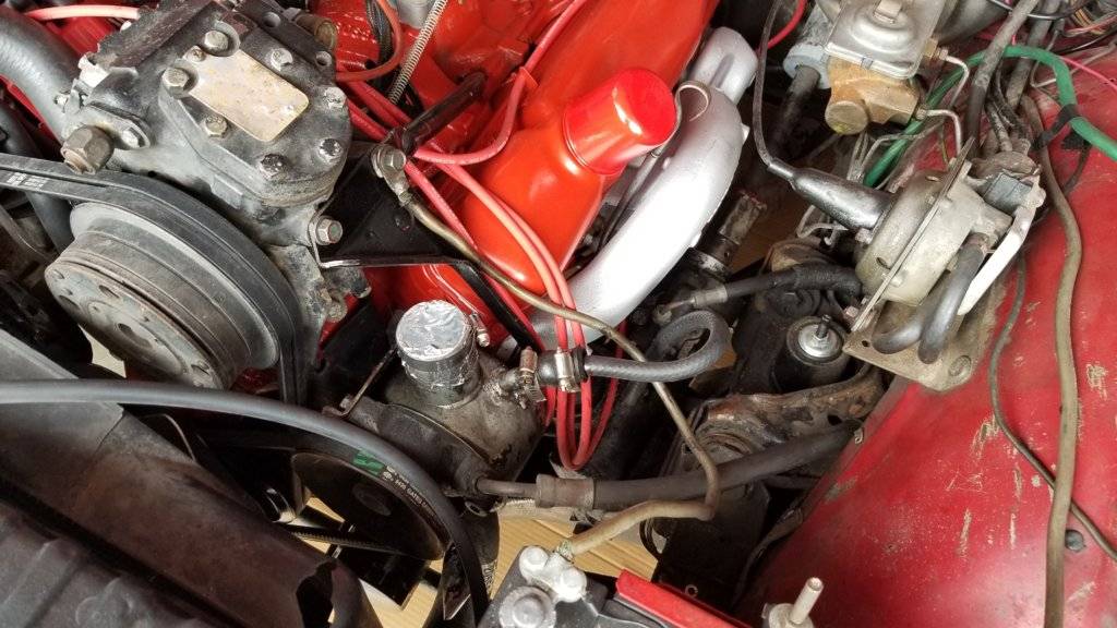

I have a good leak in my steering pump. And I've lost 2 caps so far. The previous owner may have swapped it out from a different model. Reason I think that is it looks like it doesn't have the same size hose input/outlet and they used another size of hose to adapt them together. If I could get away with just buying a cheap rebuild kit I would but 2 things, first do I have the right pump in there? And 2 I don't want the weak link of the 2 different size hoses, unless it isn't as big of a deal as my mind thinks it is. Here are a couple pics. 68 Chrysler newport 383. I see so many different kinds of pumps when I search online I don't know where to start and most don't seem to be for c body, unless they're interchangeable. Appreciate the help.

The return hose is a joke. The hose to hose clamped end could be restricted causing your trouble. The hot oil is swelling the hose. A definite problem. You could get some metal pieces to adapt the 5/8” hose to 11/32” size for your steering box and it might work better.
The pump with that large return size is 1966 and older. That return fitting has been welded on at the wrong angle.

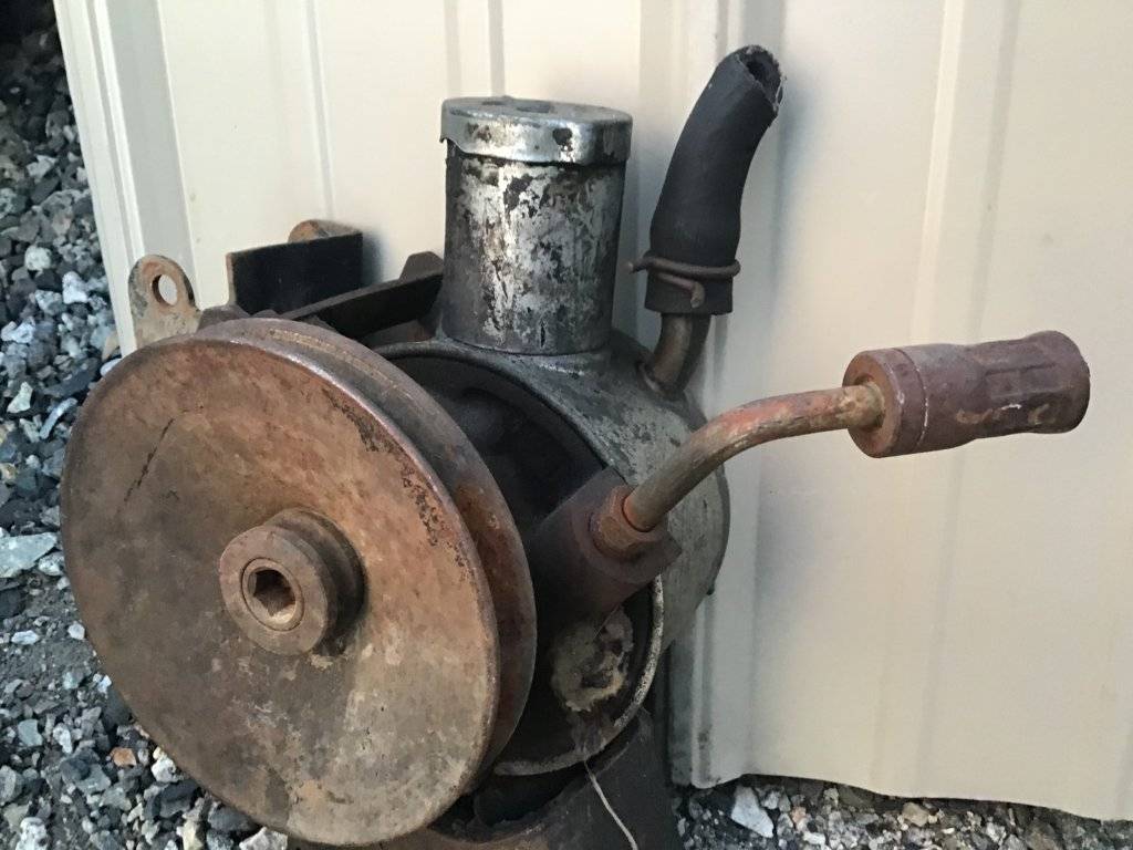

my photo is a 1966 pump. See the correct angle on the return fitting.
Your mounting bracket is a C body part

That is a federal pump...looks like the right one for a big block engine. There are rebuild kits for that pump available...Rick Ehrenberg sells a nice kit. It looks like your return hose nipple on the pump body has some issues. You may need to go with a rebuilt pump.

That return hose should be a high pressure hose, if it, (or that part between the clamps), is just fuel hose it will burst.
413
Jan 28, 2019
1,495
1,676
NW USA
It’s not high pressure there, but it does need to be an oil hose not full or coolant hose.
wrong hose gets swelled like the one on there now.

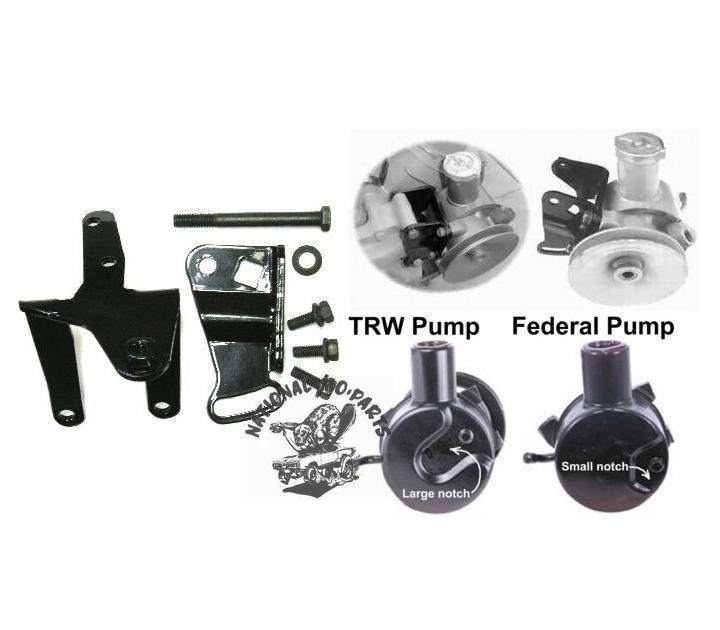

The link I posted is identical to the one from my 67 newport. Same part number..2537955 .exactly what the fsm says I'm supposed to have. I don't know about 68. Also...same bracket as in cbarges post...
206107 is the trw pump. Mine is the federal.
