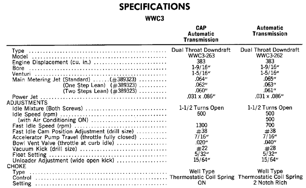

500rpm is too low for curb idle. I would kick it up about 150 or 200. Your battery will thank you.
As specified by the FSM, Chrysler, Imperial 1966:
I've found that at the canonical Fast Idle speed, 700 rpm is where the alternator starts charging. While my 4 yr old battery indeed runs down into 11-12V when at 500 rpm, my TRANSMISSION is VERY HAPPY with that curb idle. Transmissions run an order of magnitude more in cost than batteries, and having purchased one of each for Mathilda, I KNOW WHAT I'll prioritize. In traffic, the old motor and trans sit quietly in 1st gear without the slightest strain at 500 rpm, then very smoothly deliver dynamic torque to the rear end. (2.91 I recently discovered, instead of 2.76) At higher angular velocity, I might have good charge, and yes, a cooler engine even, but the transmission does best to engage at low "w", then I can accelerate as needed.
