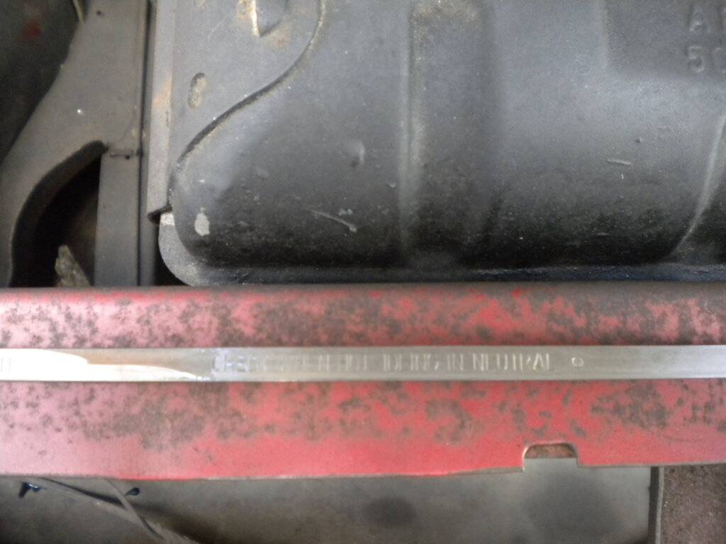

    Double check your fluid level as well. Make sure its warm and follow the correct method from a manual.

  5. rags
    rags Senior Member
    Messages:
    1,152
    Likes Received:
    669
    Joined:
    Dec 14, 2015
    Location:
    greater norwich metropolitan area
