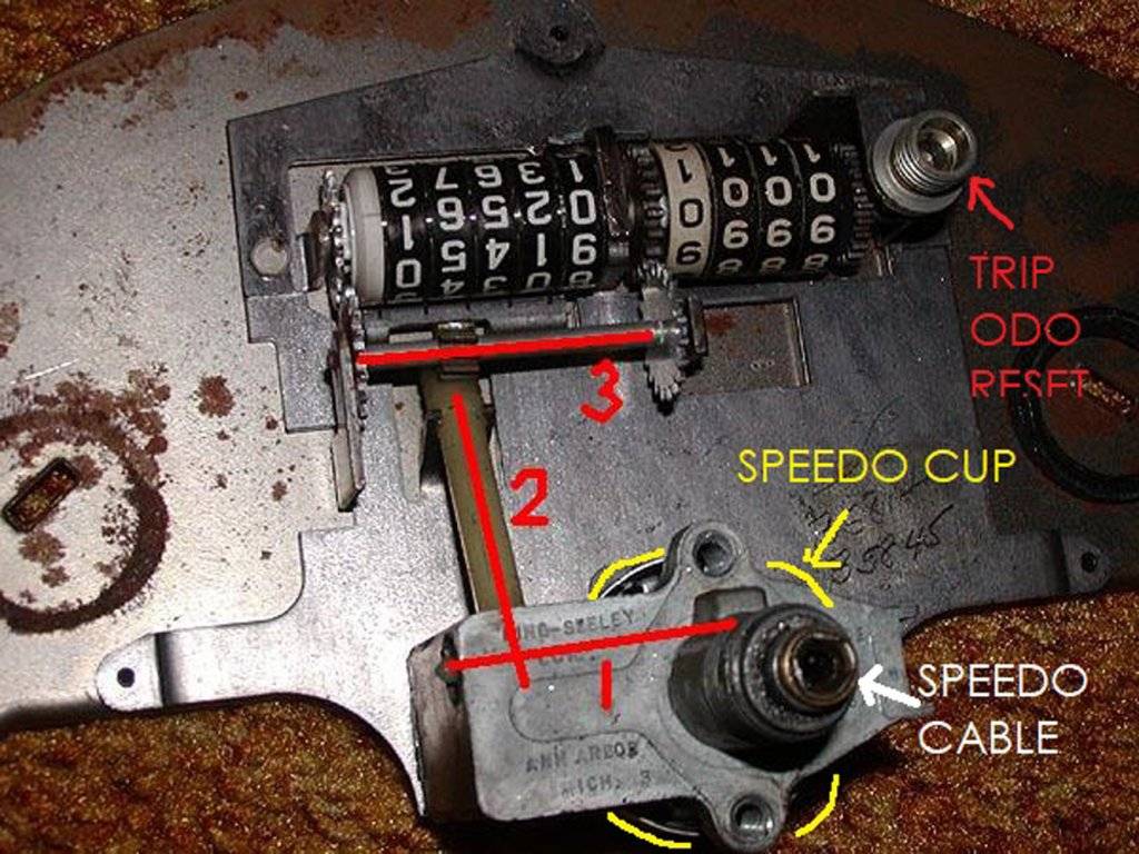

Here is what it looks like on the inside.
Shaft 1 & 2 are plastic with worm gears on one or both ends. they transmit the motion of the cable (and slow it down a lot) to shaft 3 which has a gear on each end to turn the regular & trip odometers.
What seems to happen is the odometer (usually the trip side) hangs up and that keeps shaft 3 from turning. Something has to give, so one of the plastic gears wears enough to slip.

Definitely lubing the speedo cable first. Will take a peek at the odometer assembly to check for wear/breakage. Hopefully it just needs a clean up and lube and all will be well.
