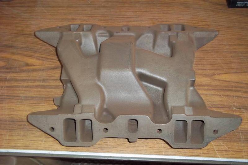

Hey Guys, Can anyone tell me if a Mopar CASTING NUMBER, 1851898 intake would be any good to put on my 1968 Newport 383? One thing I would like to do before spring is to swap the 2bbl for a good 4bbl setup.I really don't have the money to spend on new stuff.What would be a good used carb to fit on this stock car?Are the old Carter AFB's any good or should I look for a used Holley?Also, what about a Carter Thermoquad #6-2472....there is one on Ebay for $50?
Boy, that's an oldie. And in nice shape. To someone doing an obsessively correct engine detail, it's worth a few bucks.
But it's a limited market. Start advertising it now and you may get enough dough for it by the time you're ready to swap.
It is on Ebay...not mine.It is from a 1959-60 383 4 bbl.Would this manifold work well or should I wait for a used Edelbrock Performer?Also...should I look for a Carter TQ or would an AVS or AFB be better?Just something that will run a stock motor smoothly without fiddling with it all the time.Your help is much appreciated!!!
That manifold will work but a later one would would probably get you better performance. Everybody has there own preferences on what kind of carb to use, if you're on a strict budget and looking for a used one I would just try to find one of any of the above in the best condition possible. It's kind of a crapshoot buying a used carb that you can just bolt on and go.

I would get a used dual plane intake which will flow better then the original intakes and be lighter. If you want the intake to heat up the carb for good winter time running make sure the one you choose has the heat crossover .. most do. A used low rise dual plane intake should be under $150 depending on what you get.

I can't argue with that either Stan. They work well but I'd probably go for a 70 - 71 ish model if using an orig iron intake and presented a few choices. The carb mounting area doens't have the four holes .. two open slots and they are less restrictive. There are plenty of them all right.

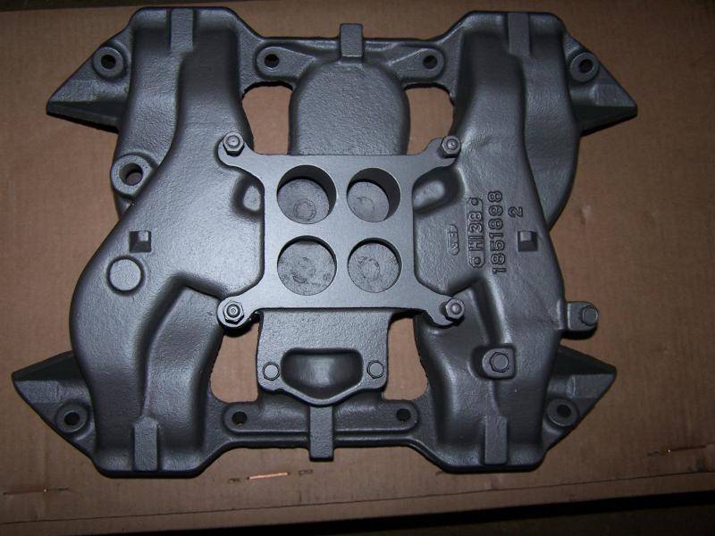

I absolutely wound not buy the one in the pic above unless it's correct for your car and you want to go that route mr onetwo
If you have to have it shipped the price of an aluminum and a stocker might start to converge unless someone gives you the iron one which I imagine is entirely a possibility. Anyone who has more than just one car and minimal extra parts has probably 2-10 of those late 60's early to mid 70's intakes. I probably have ~ 10 myself and about the same number of carbs .. carter and holley
