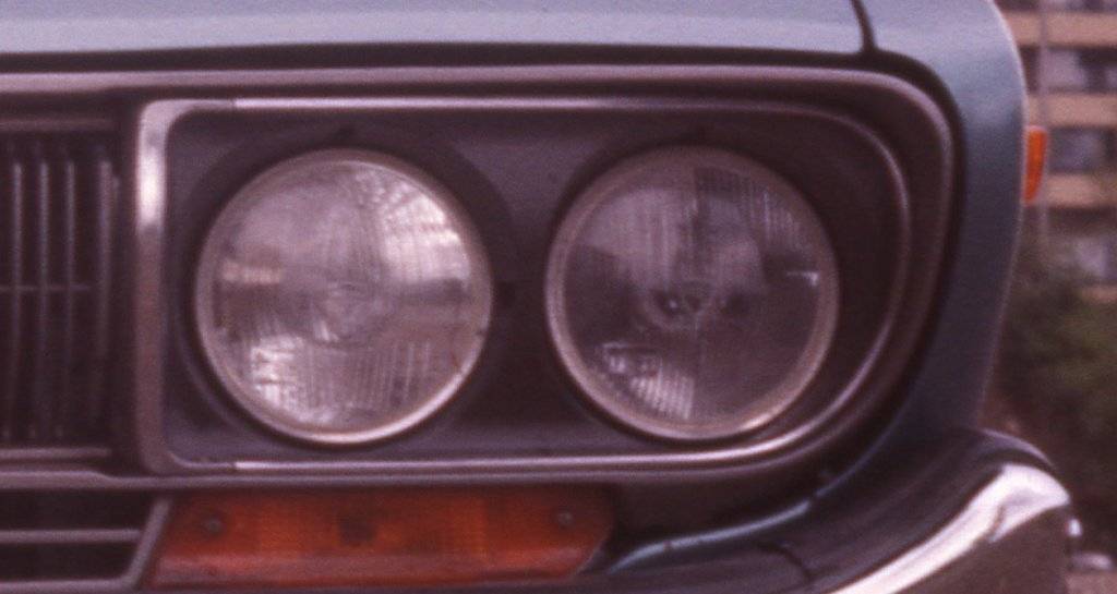

Guys, I was wondering if anyone has installed aftermarket headlights in their C. Not that halo-HID bling bling crap, but real performance headlights. I know I need a relay harness to preserve that precious toggle style headlight switch, so does anyone have any good sources on one of those that would fit a C easily? I've thought about installing a set of REAL Hella H4 and H1 one headlights, but what are you guys using?
