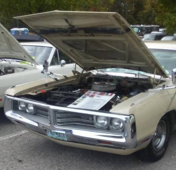

i wouldnt . it may leak like made . the full synthetic the oil molecule r all the same size causung leaks like made while the conventional oil has differant size molecules i would be putting a high zinc oil in it , it will do more to stop ware im ==n the older motor i use shell Rotella 15w40 then the next oil change i use Valvoline 20w50 i have 40k on my mild mp cam 440 it uses no oil @ all
