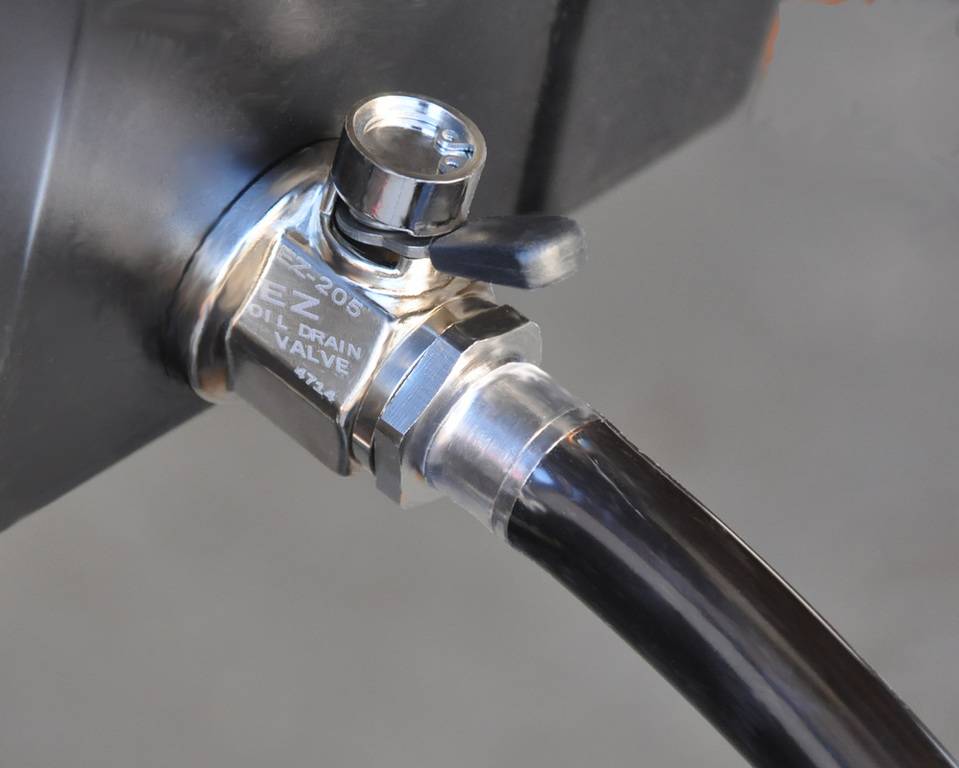

That remote control drain plug drain? I could not see that it had a positive-enough "closed" position, so it might drip and you wouldn't know it until "later".

EZ Oil Drain Valve- The Easiest Oil Change!
