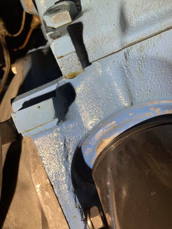

When I replaced the oil filter, I looked at the surface that the filter butts up to and it appeared smooth and clean.
I will pull the oil filter and reinspect.
However, I am asking if I should scuff the surface of the block where the oil filter gasket sits.

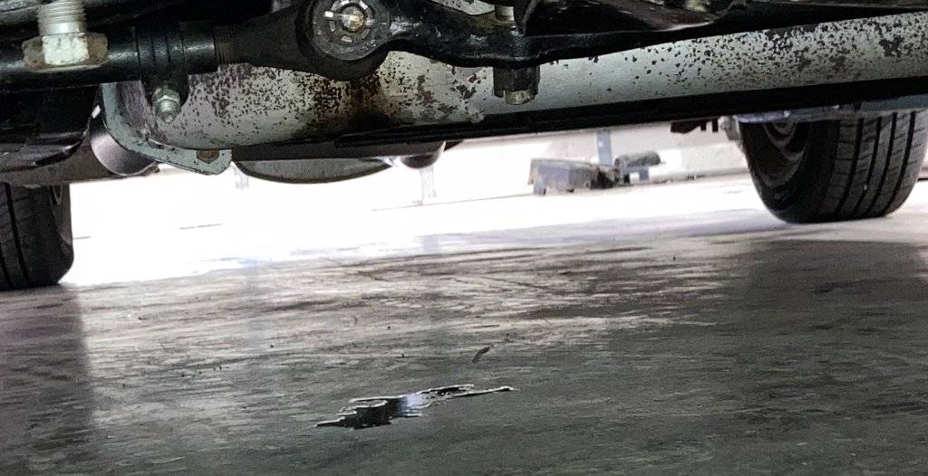

Here’s a picture of the small puddle that is present on the floor after driving the car (getting it warm) and the oil filter.
Am I missing something here?

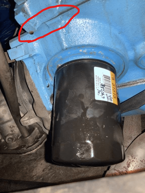

Not familiar with this engine but maybe this'll help. The mating surface of your filter looks remarkably clean and also the top half of the filter looks dry. BUT there appears to be a drop of oil in the top of your picture:
Looks to me that something up top is leaking onto your filter.

Thank you. My suspicion is that the valve cover gasket’s leaking.
I believe that I have read that the valve cover gaskets are a problem area. I will research this more…

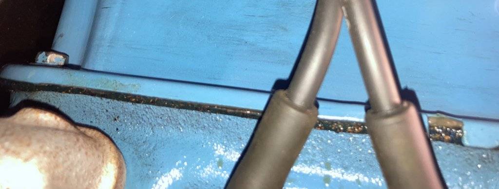

Put the new valve cover gaskets in and it’s leaking worse than before. I will revisit it in the morning.
Spent a lot of time cleaning everything and making sure to torque the bolts correctly.
I tapped flat the valve covers with a small hammer and placed the gasket carefully on the valve cover.
Cinched the bolts to snug and torqued to 25 inch pounds.
I looked at them carefully and had to flatten back the areas where the bolts go through.
I will investigate more tomorrow.

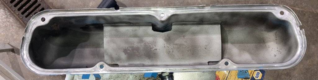

I cleaned the valve cover by using sandpaper, a wire brush and once I had metal exposed (I had to remove some silicone from the valve cover), I cleaned the surfaces with brake cleaner and then lacquer thinner.
I did a similar procedure for the cylinder head, being mindful of debris and making sure that it was all removed.

One method that helps is to use a short straight edge across the bolt holes on the underside of the valve cover
You will than be able to see the gap between the holes and the bottom surface of the valve cover and correct the over torqued and distorted mounting hole surface as mentioned
