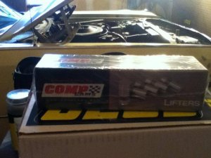

I'll soon be replacing the hydraulic lifters in my 383 with a set of new ones.....metallic tapping sounds like one has collapsed on pass side...I know its not an exhaust leak, that sounds different from this. Question is this:
In the past have you typical soaked your lifters in oil before installing them, or
did you not bother? I can get 50 who say yes, and another 50 who say no. I can see the logic in both scenarios, BUT wondering what the consensus is here.
If so, I'll be dumping them in a tub of Quaker State shortly. Whaddaya think?

Installing lifters always mandate "pumping them up" first for several reasons. The foremost being it at least "seems" like common sense.
By the way, I learned the hard way, you bought the worst lifters commonly available. Expect a lot of valve train clatter.
Sorry to be the bearer of bad news...

Don't sweat it, no apologies required. Rarely do I take information from one singular source as being THE last word or THE truth. That is why its call a consensus. Its cool.
I'm sure there's a 1000X more satisfied users than unsatisfied. If I had them already, I wouldn't sweat it.
3 to zip for soaking thus far.
I do not soak them. I install them (coated with break-in lube) check the rocker arm preload, then prime the entire engine using an oil priming tool driven by a 1/2 in. drill motor.
I won't be pulling the camshaft if that matters any, I don't see any reason to. The 383 idles properly and feels quite strong, it has not acted as if a lobe was wiped or anything like that.
