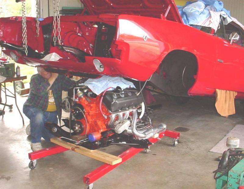

Engine r&r
This is my perfered method.........
