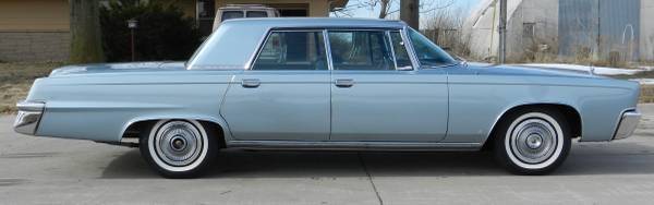

A belated :welcome: and I'm glad you made it home safe as well. Pictures will be required by the membership.
Thank you! Meet "Bess":
She's a real beauty, well done!:thumbsup:
Holy Hanna, that's beautiful! Wow, great catch, and welcome! Does she have pore event windows, by any chance?
